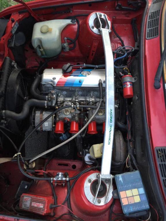

        Just buy my car:
        Engine was built by Korman Motorworks.
        The best one-stop shopping for German car parts and lifestyle: http://www.gutenparts.com/

                Just buy my car:
                and Dear God, get some sort of air filter on it!
                  <grin>
                  t
                  I have ITG foam elements. She is just sitting right now.
