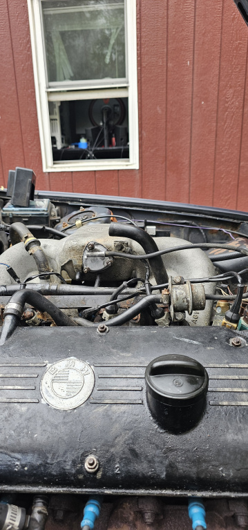

                              I'm basically reviving a dead thread here but I need to know where the butterfly valve adjustment is on the throttle body? Unless I need to play with my throttle cable to set the idle, I'm wondering how you would go about adjusting the idle here.
