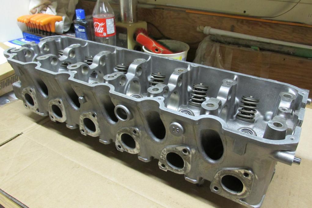

    head got cleaned up. simple 3 angle valve regrind with some new seals.
    Click image for larger version  Name:	XVyPGUYE83ajxkX6i58JGOP4au78x9Zh38nAgXQWST_LsvD7itLWzbh_vx3oM9KTo7oCZ83_fdh4eHZRvUzTmdcJxqVIVGIvME1TdEG-a2dYbS6SYAp8fIaXh3kdaeT4u4n0XVgg9g=w2400.jpg Views:	0 Size:	89.1 KB ID:	10032221
    no real porting but did have a few edges smoothed. barely touched at all.
    running original springs. machinist said there was no reason not to, felt they were good and strong, and this is more a refresh and not a real power build.

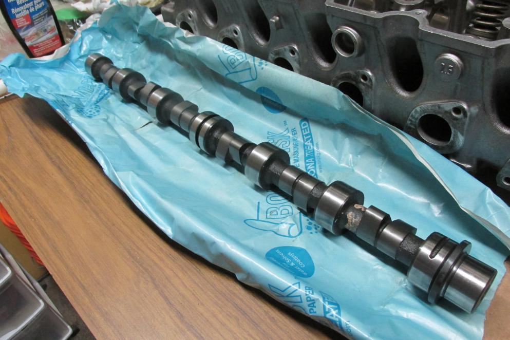

    un wrapped

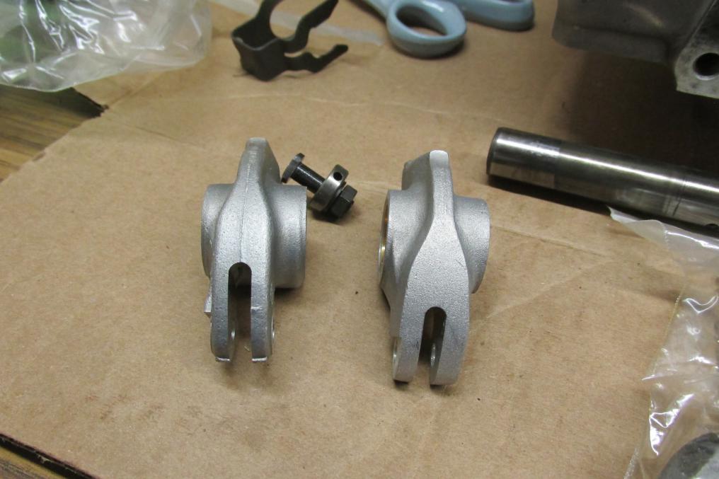

    it's going in tonight with some new hd rockers
    Click image for larger version  Name:	Lti_pJTDIVRkh_FQHS_pvhcX9Z8kUWBvIDRJXmXUgrJQrnQVIzGLdgWWij1svtmGrq2UyAw6DZjT2Xk6_gDOeYDn2Uxq76yyMUVw-vLJHrr3PS0p7jB2wWzRZ_UJv-X_6J-XXesrRg=w2400.jpg Views:	0 Size:	73.4 KB ID:	10032225
    hd on the right compared to the old one on left. the old ones were in good shapes as well. kept them. reusing the eccentrics.
