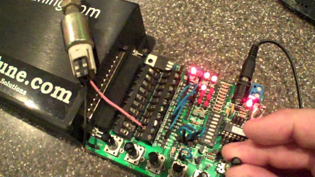

      When the time comes, it will be started on bare bones tune (ICV off) and dialled in to idle smooth (warm engine) without the ICV. Once sorted, ICV will be introduced. All that "playing" is mostly for educational purposes.
            True. I got a stim a long time ago, and messed with it for about 15min, and it's been sitting in the drawer since haha.
              I think it's cool little kit (I bought DIY kit, I enjoy soldering :) ) and let's you check every tune setting on the bench. Really easy to adopt for any other ECU
