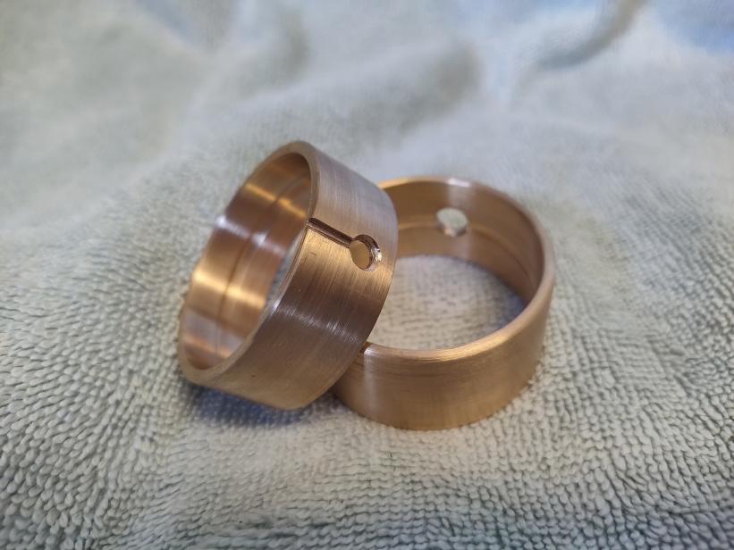

    Cast/billet 932 silicone bronze m20 intermediate shaft bearings. Part numbers 11-11-1-264-196 and 11-11-1-280-863, but better. No one in the world seems to have the inner, so I just made them from scratch for engines we are building in-house. Already turned to ID for direct press and ream. Feel like making jewelry. lol. These need one more operation (oil hole), and ready to install.
    Click image for larger version  Name:	IMG_20220427_152640~2.jpg Views:	0 Size:	81.8 KB ID:	10054315

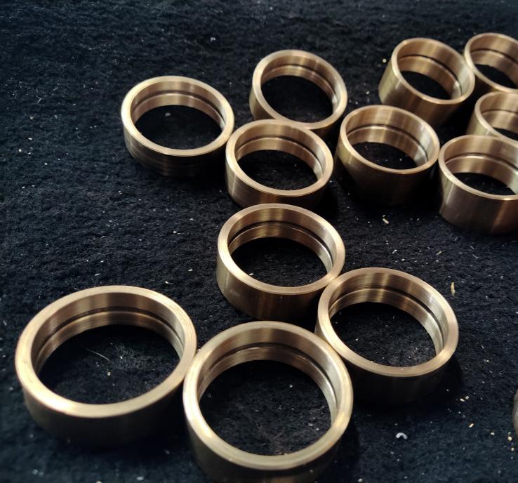

      Very nice! Making extras that we can buy?
      Looks like you could make up some nice cam bearings and save some old worn out heads, just need to make a boring bar setup 8^)
        You're the fourth to ask, so sure: https://www.r3vlimited.com/board/for...rings-upgraded
        Quite a long bar, too! IIRC the m20 cam bearings are already available. I might worried about thinning the cam valley (where they always crack), though.
