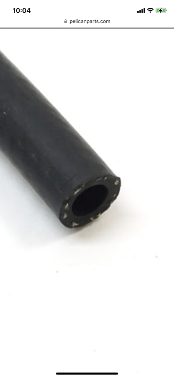

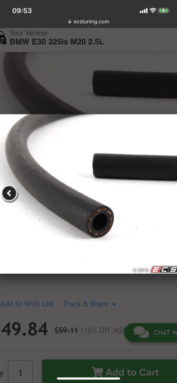

                BMW gets their hose from someone, and the line probably isn't completely proprietary. IIRC last time I looked up the info printed on BMW fuel line the main difference versus the CRP line was the reinforcement mesh material. I suggest you look at some photos of current or near current line, decipher the labelling, search for those terms, and buy something that is as close as you can to the spec. You can also report back if you do the research.
                Pelican parts picture is CRP 8x13mm 5 bar hose. $10.75/meter. I can’t make out any marking on the actual hose to research it further.
                ECS picture is genuine bmw hose $49.84/meter.
                The braiding on the inside wall of the genuine hose is noticeably more tightly stitched, and it looks like it may have a thicker wall. If these are recent pictures of course.
                Easy choice here, genuine for safety and quality. Thank you all for your responses
