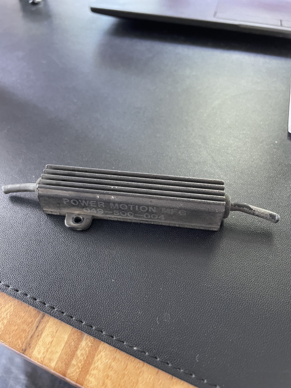

    reelizmpro hozzziii Not sure how this can be, but I cut the low speed resistor out and jumped it (changed the fuse to a 30 amp) and fan kicks on perfectly with the AC button. Who knows...now for the fun part I seem to have a fan by the brand name "power motion" and it has a "power motion" resistor that looks similar to the Magna one, but not identical. I cant seem to find anything by the brand name power motion. Have you ever heard of it? Should the stock resistor work? Thank you so much for the help!!
      I've never heard of it. What is the resistance of the resistor?

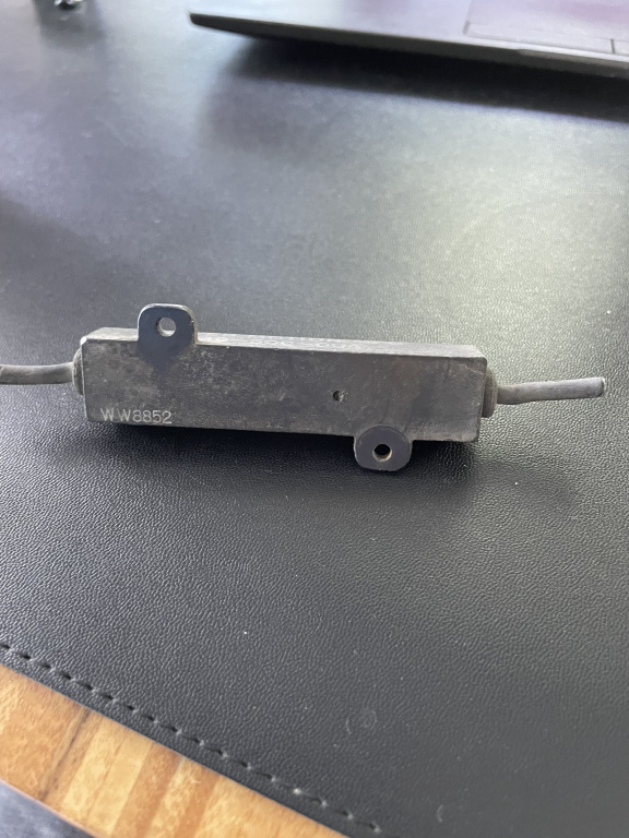

        reelizmpro I’m not able to get a resistance reading on my multimeter. Click image for larger version

          I had thought about changing out the rating on the wire wound resistor to change my fan speed for my m30 swapped car. I didn't want it to run max speeds all the time because it was too loud and the low speed was not enough to keep my AC cool at stop lights. Factory replacement "Magna" resistor(ACM) is about $20... but about $10 on amazon for a no name brand. The resistor rating is 85w - 0.5 ohm.

              reelizmpro hozzziii ok, so new resistor arrived although the wire is a little thinner at 2.5 mm vs the wiring in the car that appears to be 4 mm. I used alligator clips to test the resistor and worked like a charm. However the resistor after maybe 30 seconds of run time was very hot. Is this normal? Can you guys let me know if yours gets very hot?

                Yes that is how it's designed to work. Resistors resist the current that's trying going through the wire and that's why you get low speed cuz there's less current going through.
                However in doing so, the do absorb some energy and get hot, and they need to get cool otherwise it could melt and now you have now resistor.
                That's why the resistor has these fins on it that help keep it cool. That's fine for the environment it's in, it's just in front of the car, getting airflow. You're good.
