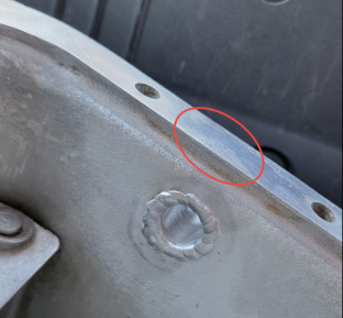

    Lower oil pan gasket, double up?
    I just got a bung welded on my lower oil pan for my turbo drain line. The guy that welded it mentioned where he welded may have shrunk the metal a little and thus pulled the lip down a fraction. He said guys run 2 of the cork gaskets or put some extra RTV in that spot. I should be ok with some extra anaerobic sealer right?

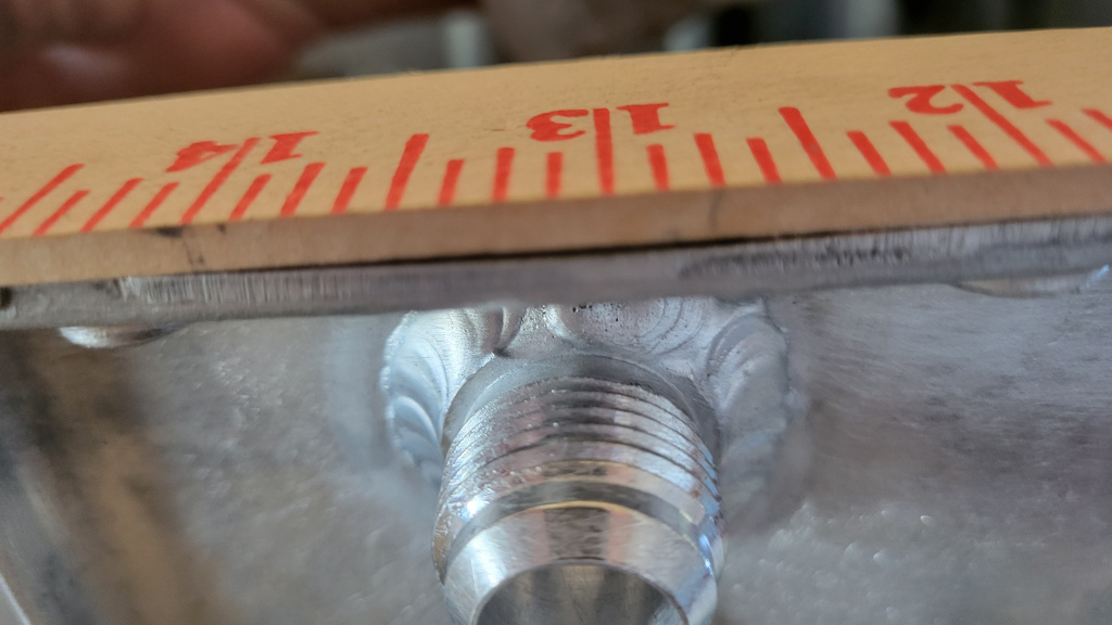

    I would put a straight edge on it and measure the gap to be filled and then make a decision.
      Thanks it looks tiny enough to use sealant. Doesn't make sense to double up the gaskets when the rest of the pan is straight.

        I would never double gasket it’s asking for trouble. Use a suitable sealant.
        Just do some research to find one that’s compatible with Aluminium and cast iron (active metals) has resistance to fuel etc not just oil. Don’t just use your average auto shop sealant as you may not get maximum longevity
        • bangn
          • Sep 2011
          • 760
          yep big no no using two gaskets. Sealant def the go here or even aluminum epoxy and block it down level again with a cork gasket to finish.

            Copper silicone holds up well even under exhaust heat, but there could be something better out there.
