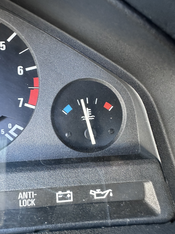

    Well, took it out for a three hour drive and it seems to have fixed itself. Temp gauge needle sits a couple hairs above the 1/4 and only rises to the middle when idling at a stop light (needs new fan clutch). Perhaps the nut on the cluster is loose?

      • reelizmpro
        • 9552
        If it's jumpy then you know there is a grounding issue. Try tapping the cluster in front of the gauge to get it to settle. Mine sometimes reads high even with the nut torqued down and solder reflowed on the main board. I've been told that the SI board could be the culprit but I haven't gotten around to changing it since the car is not actually overheating.

            It was the temp sensor. Replaced it and needle is back to between 1/4-1/2 and steady. Before that, I tightened the nut on the cluster, replaced the fan clutch and bled the system and the needle kept jumping. Thanks for the help yall!
