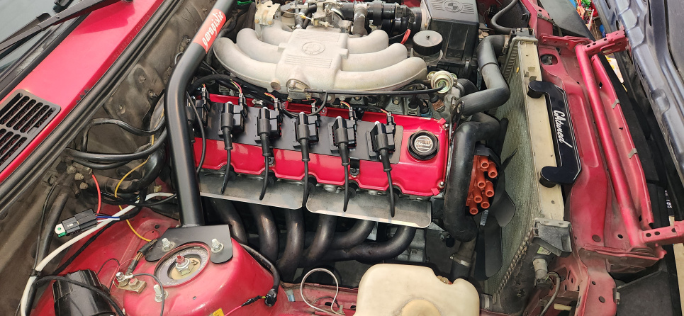

        So today I installed my individual coil pack setup and new ECU from Classic Daily. A few things need to be adjusted in the tune. But the car now is night and day from what it was. It runs so much smoother. Zero hicupps/bucking at high rpm. It starts way better than it used to.

          Nice that's great!
          How does the crank signal look in the trigger log?
            I haven't really looked yet.

              Took the car out again today. Took it all the way to redline. No bucking, no gauge needles jumping, no misfiring. I feels great to have this car back and running without issues.

                #37
                I wouldn't run it hard on a base map. Depending on who did the tuning it could be close, or way off and risking the engine.
                Did you set base timing with a timing light? Should be first step with a standalone.

                  Awesome to hear it is running well!!
                  I did the tune and it is VERY close after doing lots of these on the same ecu and also very conservative on timing. But still will need some tweeks I am sure as every engine is a tad different.
                    Nice. Good to hear that timing isn't too aggressive.
                    Lot of canned tunes hinge on good fuel quality, which IMO is only okay if you have knock sensors and can dynamically pull timing like the original ECU.
                    Do you have instructions for the end user to set base timing during the ECU install?
                      It's easier to email him from his website. That's how I talk with him mostly
