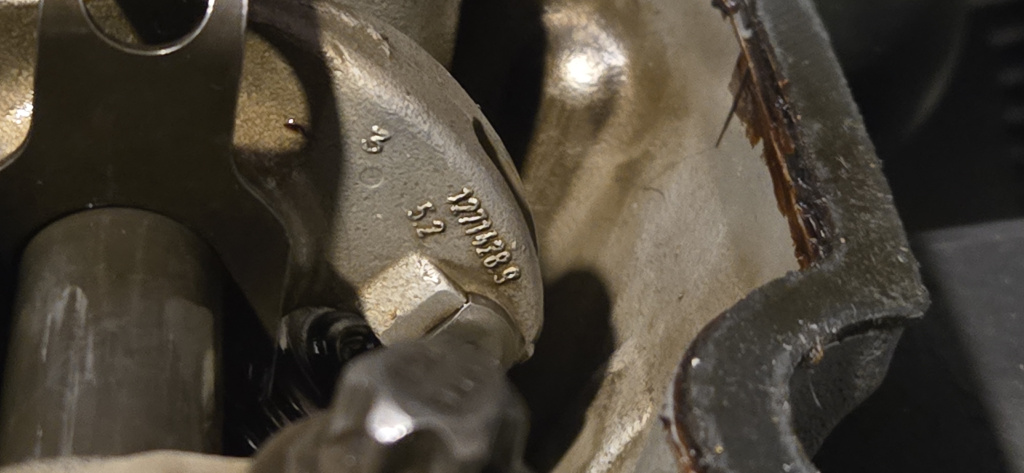

            Originally posted by digger
            what oil and rockers were used? there are no banjo bolts presumably you mean oil sprayer tube nuts (it is different to the m30 and you seem to be confusing the two e.g. crimping the sprayer bar)
            Not sure on the rockers. I got the cover off now and snapped a pic. Oil is Mobil 1 5W-50.

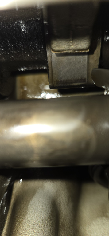

                        So, I found pretty noticeable tappet wear tracks on both lobes on cylinder 2 and less so on 6. These might very well stem from the tighter clearance I set last week on those 2.
                        That said, the intake side lobe tip has some light scoring I can feel with my fingernail and if you zoom into the pic closely, more wear in the center than the outsides and some small damage.
                        I know the lash was adjusted way too tight when I got the car 0.007 or even 6 on some cylinders if I remember. I'm pretty sure the cam and rockers were replaced as it was a full deck to pan rebuild on a high mile motor.
                        That being said, at 0.008 at the valve stem, I should have already compensated for this level of wear sufficiently to produce no more than a tick, not this fairly loud tapping that also goes away, no?
                        The engine still needs to fully cool down again before I can check the clearances on #2 and try to tighten it by another thou just to test if the clacking stops. If not, I'll listen with the stethoscope then while she's idling to locate the source.
