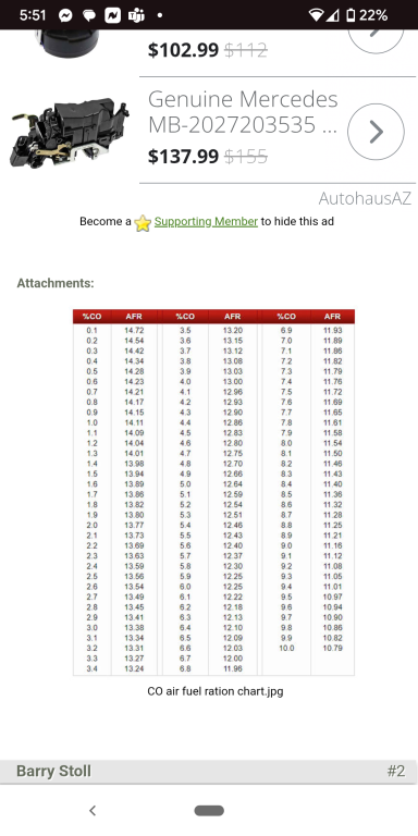

          Per the Bentley book, the CO% should be between 0.4-0.8%, which would equate (per attached screenshot table) to 14.17 - 14.34 AFR.
          Am I missing something?
