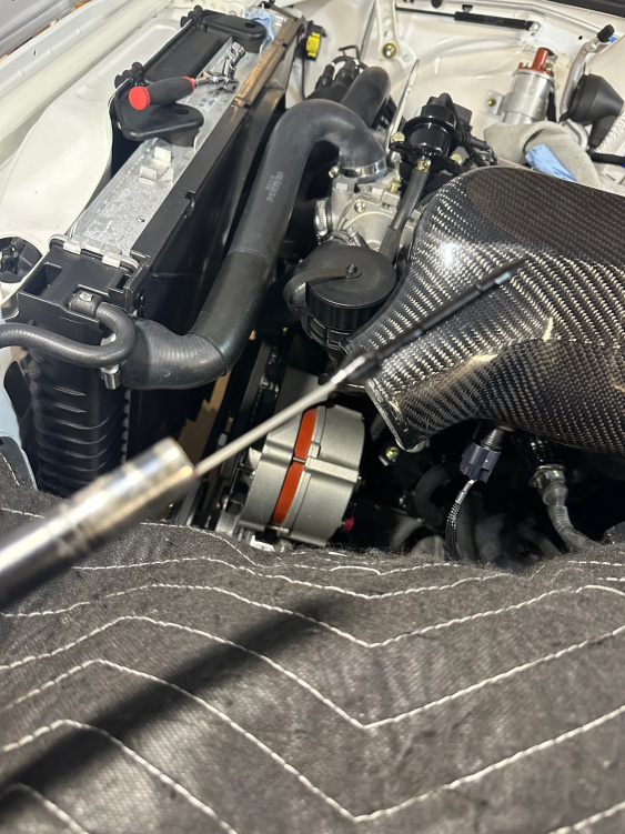

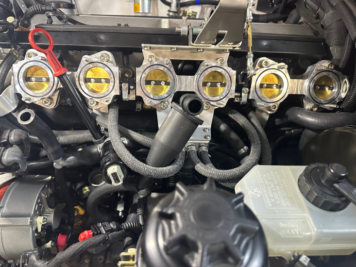

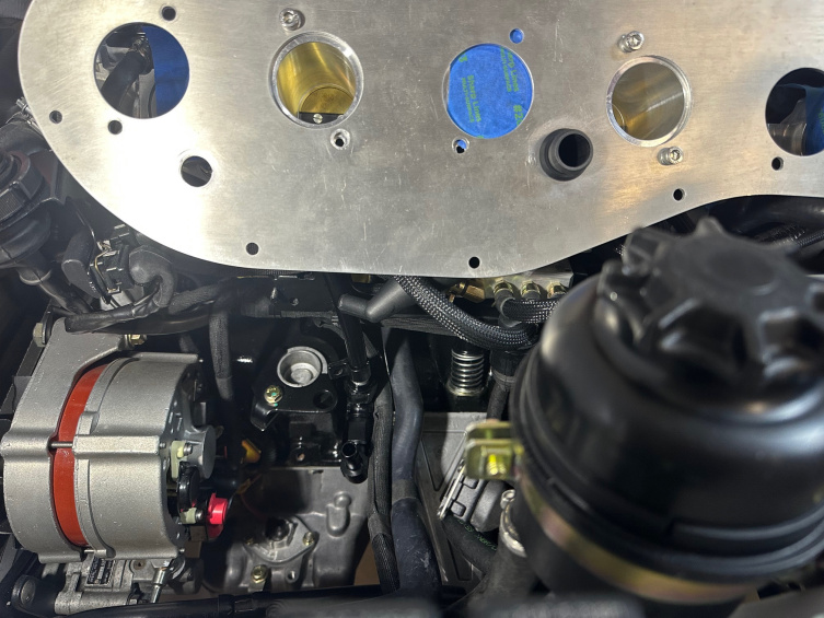

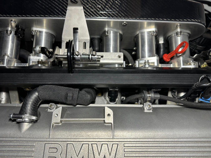

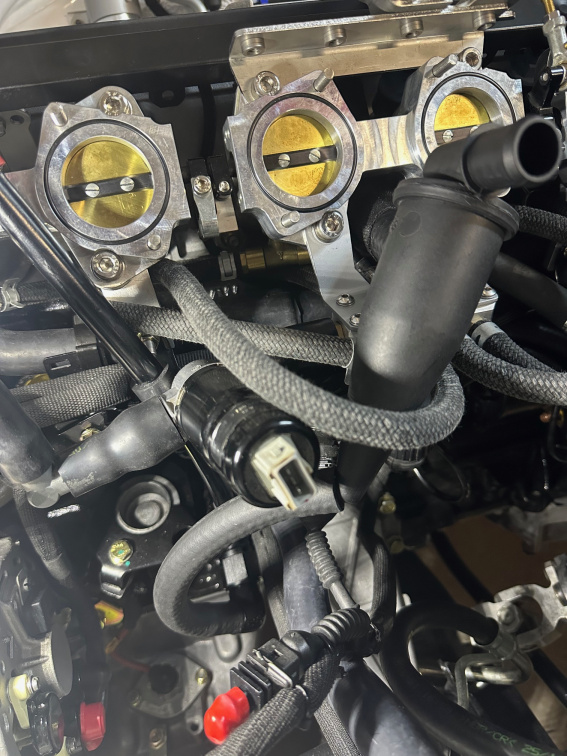

    Ok. here is my setup for the crankcase venting/oil separation with a return to ITB airbox. S62 oil separator that drains into the dipstick. Haven't tested it yet due to shit weather/lots of road salt at the moment. For those who is familiar with M20, should I run the check valve on the oil drain line to the dipstick since the dipstick is above the oil line in the pan? Not sure if the crank pressure will push any oil up into the separator while the engine is running. Something like this (link) or not needed for NA M20 in your opinion? https://www.lingenfelter.com/product/L200030000.html
    Click image for larger version  Name:	image2-3.jpg Views:	0 Size:	179.7 KB ID:	10135124 Click image for larger version  Name:	image1-3.jpg Views:	0 Size:	213.4 KB ID:	10135125
    Click image for larger version  Name:	image0-4.jpg Views:	0 Size:	210.2 KB ID:	10135126

    to me i would probably use one

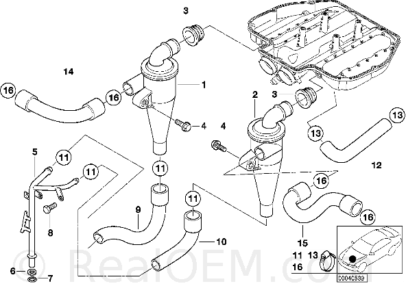

      I'm thinking the same, considering S14 design has oil drain tube submerged. However S62 doesn't have any check valves and it goes into the tube above the oil level?

        Hmmm. so bitch tube to the separator, separator cyclone
        to air filter, and bottom separator oil from separator to submerged dipstick?
        Yeah, I'd probably run one, too-
        in theory the bitch tube should do all the pressure equalization,
        and the ever- so- slight negative pressure of the intake will help when you're on low- throttle cruise.
        But being open to intake, if oil ever backed up, that would be... expensive...
        The 4 cylinder Alfa with IR and Spica had an interesting little catchcan that had a vacuum break on the
        drain- I had one around for a long time, but lost it in the last move. Along with the oil filter cutter...
        Those cars were a great source of 1- way fuel valves, odd little linkage parts, and fittings.
        t

          i would use it out of the abundance of caution, however, if you have the same system/architecture as per S62 unlikely crankcase pressure can push oil up that far with a NA engine?

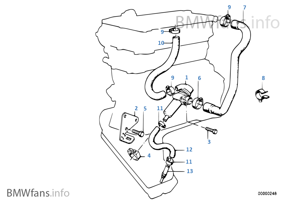

            dipstick tube on m20 is not submerged into oil (similar to S62) hence my concern of some venting into the oil separator from where the oil will be draining from it. On S14, oil separator drain is submerged into the oil in the oil pan via 13 below, so technically no venting into the separator.

                I just actually read it lol..No, the bitch tube is still there and not affected.
                The setup is : Value cover vent to the separator, separator into the air box, the bottom separator oil drain into the dipstick tube.
                Here is a view from another side..
                Click image for larger version  Name:	IMG_9334.jpg Views:	0 Size:	178.1 KB ID:	10135254

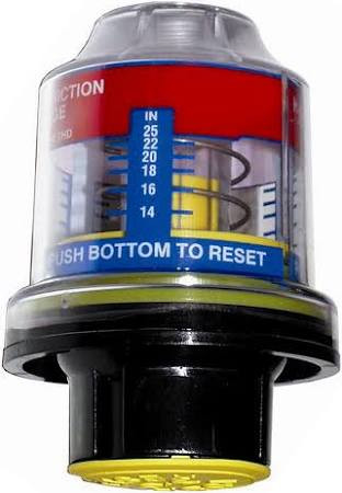

                  The black port on the left side of the airbox is just a plugged -6AN fitting. I had valve cover routed there originally before decided to introduce the oil separator. Now it just plugged hole. I actually going to put a vacuum gauge there to see how much vacuum if any gets created in the airbox ( I made a paper gasket for the box so it's sealed). Probably won't be any unless the air filter gets dirty?
                  Here is a gauge. gradated in IN H2O where 14 is about 1 inHg and the max 25 is 1.8 inHg (0.9 psi). The gauge holds maximum recorded reading until reset. I mainly want to see what it does because I'm using somewhat small(ish) cone air filter with the setup (not much space there with ABS unit) so I want to see if the air filter flows enough air for this 2.9L engine (no excessive vacuum in the airbox at WOT with 0.7+ psi being excessive for the clean filter ???).
                  Any thought on this? https://www.youtube.com/watch?v=J1pgbJJ3boY
                  Or I can just log and look at my map sensor reading ? I guess at WOT vacuum in the airbox and the vacuum block theoretically will be the same? What should MAP sensor read at WOT compared to idle? Ideally is obviously zero vacuum at WOT but what is the acceptable vacuum as not to be considered restricted air intake?
