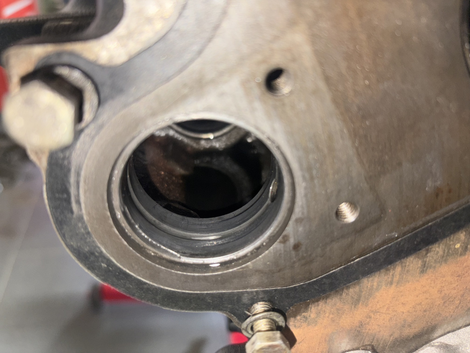

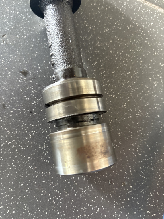

    M20 intermediate shaft failure
    I have built a stroker engine but after putting it in the car and just driving a few kilometers it started to develop a loud knocking sound. After tearing the engine apart again I saw that the intermediate shaft got shaved by the clip that’s retaining it which has caused massive play on the intermediate shaft and the metal shavings caused the rod bearings of cilinder 1 to be spun.
    So obviously I need a new intermediate shaft, a new rod and some bearings. However I have no idea why this happened and don’t want to spent a lot of money just for the same thing to happen again. Couldn't find something similar on Google either. One thing I have noticed is that the shaft can be easily inserted and removed into the block without force. However I have a b20 block here where I tried to put the shaft and it requires a bit of force which led me to believe that the bearings have too much clearance.
    Could too much bearing clearance have caused this? And if so how can these bearings be replaced because as I understand those are pressed in with a specialised tool by BMW.​
    Did anyone here ever had similar issues or know what could have caused this. I’m really clueless, everything is basically new and measured to spec.

    Is that original intermediate shaft to the block? That retainer grove looks way too wide. It should be not much wider than the retainer itself? Or the shaft journal really got chewed up that bad? Was block hot tanked as a part of your build? Was shaft bearing replaced as a part of the build? There should be 0.001-.00015" clearance so I would not call it as a tight fit but should be wobbling in there. It should feel similar fto how the camshaft is in the head which has slightly larger clearance which I believe is about 0.0015" to 0.002"​
    • Knoopa
      • Apr 2025
      • 9
      Yes the retainer groove was chewed up, it wasn’t like that when I built the engine. The block got cleaned by the machine shop so I assume they hot tanked it. It does fit pretty tight but I can slide it in and out by hand easily, when putting it in the b20 block where it originally came from I need to apply some force to push it in.
      However the main question is if too much bearing clearance would cause this. It seems like something pushed the shaft towards the retainer which led to it chewing itself but it’s hard to imagine that a little bit too much bearing clearance would cause that. But as that retainer is the only thing holding it in place I can’t really think of anything else that could have caused this.

                Think of this scenario: clearance is too large which makes the shaft to sit cocked in there, against the retainer edge like against freaking lathe blade. All that tension from the timing belt is trying to pull that cocked shaft out. Clearance is so large that there is not enough pressure to built any sort of oil layer between the shaft and bearing to counter the belt tension. Cocked shaft, no pressure, lots of tension from the timing belt...
                Just my version of what happened.
                Don't forget to measure clearance on both bearings when pressed into the block. Why those bearing and/or shaft need to be cut and measured only after pressed into the block.

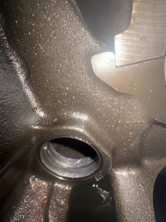

                        if they hot tanked it they destroyed the babbitt bearing for the intermediate shaft. you can't hot tank it with the bearing in.
                        edit: the issue won't be a mismatch. all im shafts are the same spec.
                        the only time anything changes is when you remove the bearing itself. the specs and shafts are not individual to the engine at all. if you remove and hone the area for the bearing, then you have to check the bearing spec for the right one. they are all identical from factory otherwise.

                          There is evidence of the front bearing flaking away and rear bearing edge loading so perhaps it was the rotation cuased by failure / damaged bearing from hot tanking or fatigue causing thrust issues.
                          Was the thrust plate new? Note that the shaft is only case hardened cast iron so once it wears a bit it will accelerate wear rapidly and it is hard to examine the surface of the thrust groove.
