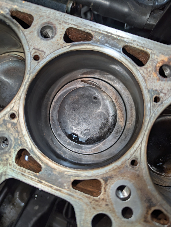

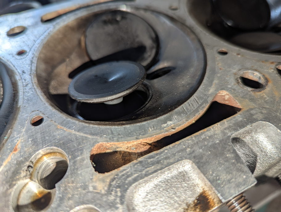

            I lapped the valves because I was replacing them due to a timing belt skip at startup the last time I installed the head over a year ago. Other than the plug being black and smoke coming from both the exhaust and vent on the valve cover after boost... I did not see any major build up of carbon or oil because It's been about 4-500 miles after my first rebuild attempt.
            When I mentioned tight I was referring to the adjustment of the eccentric. The rocker even at the lowest point on the cam lobe had no free play and that I would assume would have left that valve slightly open even when it was supposed to be closed. I did readjust it properly afterward and took it for about a 50 mile drive and it was still smoking after boost from both the valve cover vent and exhaust and I mean embarrassing smoke. That was when I did the compression and leak down test and saw the discrepancy on this one cylinder... and I repeated that test 2 times and one other the following day to make sure the fatigue factor wasn't the problem... Then I pulled the head... Odd thing also was that I did the same leak down pressure on all the cylinders and I did feel some air that came up from all the exhaust valves... not sure if that is to be expected.
            I do not see any signs of collision on the pistons or valves... they all "seem" to open and close just fine... and I repeated the acetone test this morning on that one cylinders valves and I see no leaks... I also took alcohol and measured 2 equal amounts and poured it down the bore of the low compression cylinder as well as the same amount in a cylinder that had high compression... AND... the one that had high compression drained out before the one with the low compression... so I would assume that means the rings are as good in the low compression cylinder as they are on the good compression cylinder... I just poured in enough alcohol to be 1 inch from the top end of both the cylinders and both took over 10 minutes to even reach the top of the cylinder but the higher compression one drained slightly faster. Cross hatching is still in place on all cylinders.

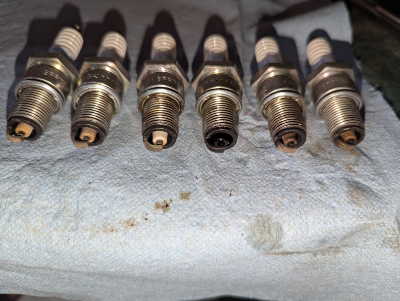

              The black plug could be an entirely different issue. Check the plug in another cylinder, inspect the ignition cap and rotor (sand off corrosion). Check your plug wires. Perhaps it’s a leaking fuel injector that’s making your cylinder rich, you could move it around to a different bank (1-3 vs 4-6). Try moving wires/sparkplug/injector one at a time to isolate the issue.

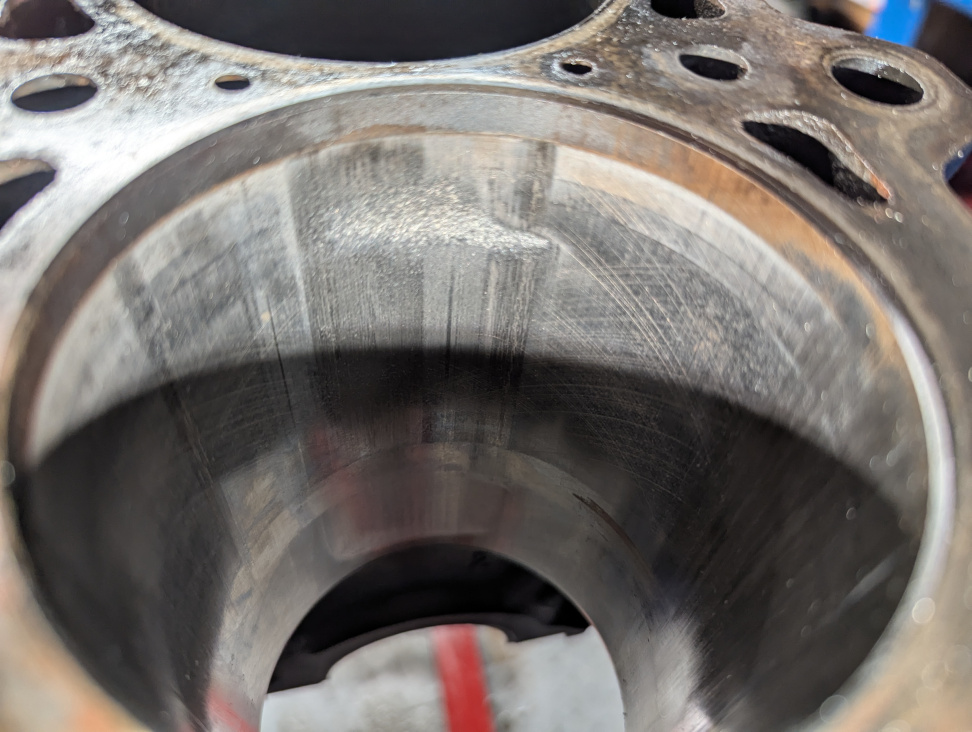

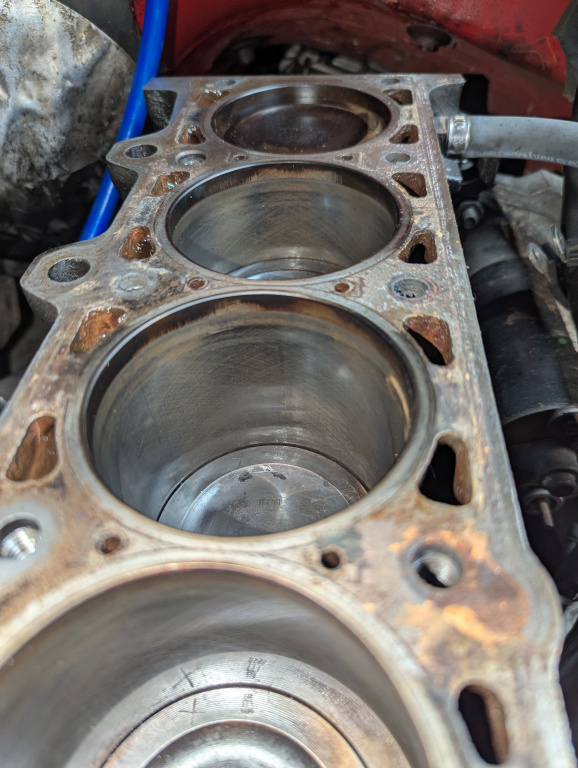

                    I did hone the cylinders well and the cross hatching is still there but I am not sure whether what I am seeing is what is right... I clocked the rings as well as used break in oil and have changed since the first 100 miles... one thing interesting in the first link was how it mentioned running overly rich could possibly cause the rings not to seat properly I guess because of the "wash down" impact of too much fuel. My setup likes to idle at 13.5 AFR so not sure if that was a contributing factor. The link mentioned an AFR of 10 but I would never do that at idle... engine wouldn't like it anyway.
                    Sorry thing is that during tear down of the original B25 block I remember why I switched years ago... 1 of the pistons is missing a chunk... and there are a few nicks in that bore... so I am not even sure whether that block can survive... but worse case I can use the E block with the I rotating assembly and pistons... everything but that 1 piston and block look pristine... so I would need to source another I piston to rebuild that. Not abandoning the E lower I have now just yet... I do think I was overfilled... but not by several quarts...
                    When you build an engine that is supposed to be lower in compression (such as with the E flat top pistons and I domed head) would you expect that the compression numbers on a compression test be lower than normal? Including a pic of the suspect cylinder... cross hatching didn't come out to well in the pic but it is there. All the piston tops have the same build up... I'm just not educated enough to know whether the amount of cross hatch is still good enough... The rings look in tact on all...

                      Here's a better picture of the cross hatching as is now... also a pic of the plugs and how bad that 1 was... and a pic of the valve I suspected but am questioning whether my test was valid. That one plug may have indicated a stuck or leaking injector I guess... that may have not let the rings seat properly washing that cylinder down so I will test that also.

                          Ordered an ELRING HG just to bolt the head back on and test again. Not sure whether the rings seated right or not during break in. Will fill her with the right amount of oil after reassembly and I cleaned out the injectors and took some emery cloth to the dizzy and rotor... I'll run her for a bit no more than 7 psi boost and see if she settles in... and hopefully that one cylinders rings seat if that is the compression issue on that one cylinder.
                          Really discouraged now cause I see that one of the cylinder bores on my extra block really doesn't look good either... was thinking about rebuilding that block as a backup... and now I saw one piston had damage which I see now damaged the cylinder bore... is it ridiculous to even try to hone that out? Don't know whether it's M50 / 52 swap time or not...
