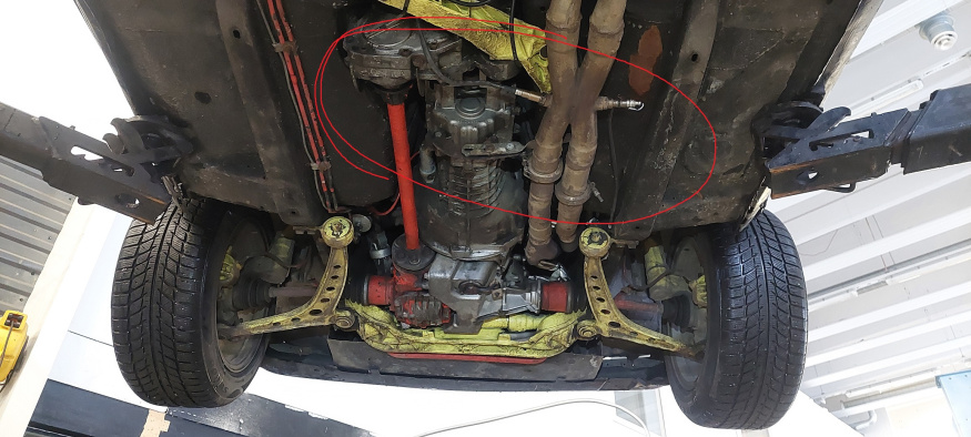

        To me yes, here is my e30ix, it has those "ears" where maybe rwd transmission arm/bushing mount, cannot say 100% sure, but you can change that rear end on gearbox from rwd to id trans..Also to me that driveshaft flange is different ix vs rwd
          yeah driveshaft flange is different, IX is studded one and a different bolt circle as it mounts to the transfer case. But looks like output shafts are the same so RWD flange should bolt right up.
