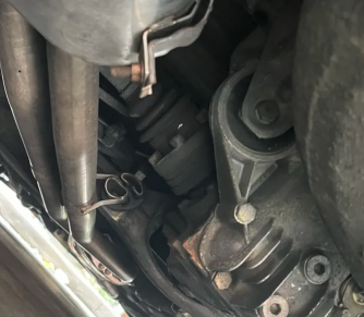

                Belated reply but yeah, the RTABs and subframes are originals as far as I'm aware (as in, I don't think they've been changed). The rear diff bushing I'm not sure, I saw faint signs of rubber aging but not enough that it looked like it had to go yet when I got a peep at it last time I was under there proper, here's a recent photo I stuck my arm under the car for, pretty sure it's stock:

                RE: Sssquid we'll see what he has to say when I reach out to him after my rear suspension work and maybe headers are sorted out, I have that MAF conversion + injectors + general engine bay refresh slated for next-on-the-chopping-block.
