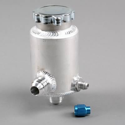

                • Dirtbleed
                  • 495
                  Moroso AIR/Oil Seperator. I see it's sealed to keep PCV, and the joe's was vented which won't keep the PCV.
                  • SpecM
                    • Oct 2005
                    • 4531
                    ^ that would work well
                    1989 cirrisblau-metallic 325i
                    • Hallen
                      • 1008
                      That's cool. I have been looking for something like that ever since I had to clean the nasty, sticky, gummed-up oil from my intake manifold. That stuff can't be good for air flow.
                      It looks like it is only $99. I would be interested to see how you run the hoses for it and how you mount it.
