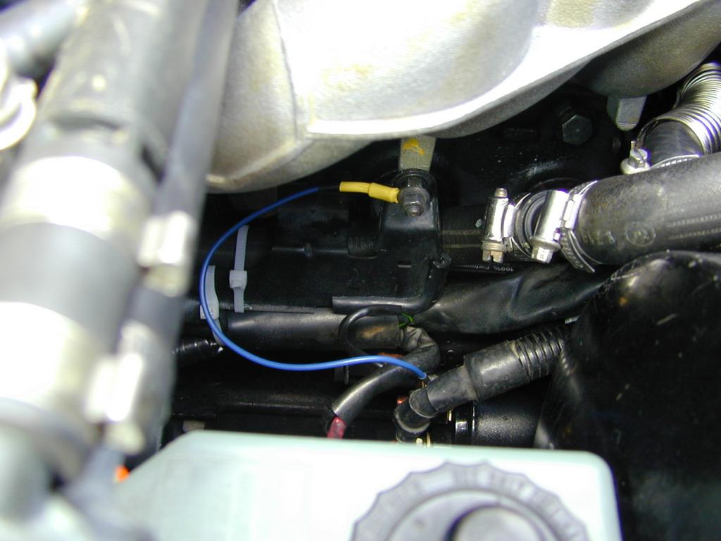

          I blocked it with the proper screw/washer. Then I re-did the plumbing and removed all that wasn't necessary. (you can see the screw in the upper right of the picture)

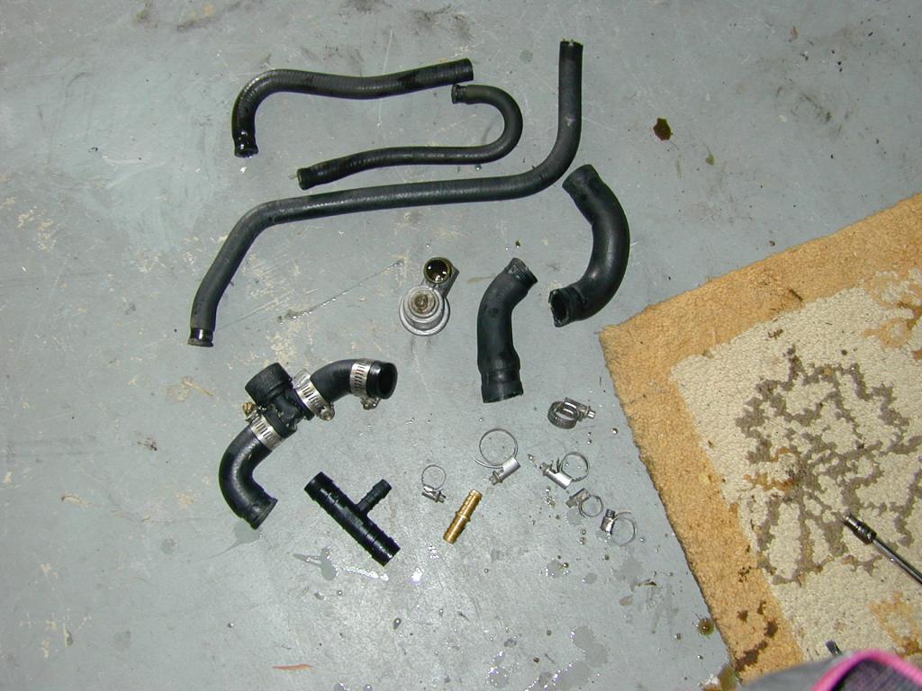

            removed all this crap.

              lookin good, what is the purpose of heating the throttle body anyways, doesnt hot air somewhat hurt the car?

                The purpose of the throttle body heater is to prevent the throttle plate from freezing in cold wet weather. That may sound far fetched, but I've experienced it in two different cars (neither were BMW's). It can get exciting when you lift off the accelerator and nothing happens...
                Since the cooling system would normally have coolant flowing through the TB hoses, I think it best loop the hoses if you eliminate the TB heater. The opposite is true of the heater and those hoses should be blocked off if you delete the heater.
