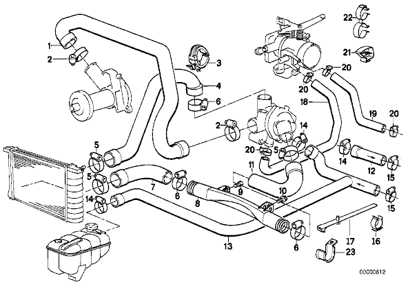

    This is where i get fuzzy:
    use splicer to connect feed tube from old res to new rad mountd res?
    #13, in a late model car, comes up from the frame rail area. All you need to do is cut it at the frame rail, insert the splicer and add another length of hose to the m42 rez.
          For those of you not running power steering (clearance issues i believe, not 100%), and want more cooling capacity, the E34 525i radiator is M20 sized and has the attached rez as well.
          whre does the other end of the #13 circut go? is that the feed or turn line for the heatercore?

                  So I would need an M42 radiator, with late-model water pump?
                    Let's keep this going, I'm still very interested in doing this. Any new info to report? I'm going to start looking for a good condition one soon, and start getting to work on this.
                      Im still in limbo, and wont be doing this work unitil the springtime.
                      I would stil like to know what is on the other end of circut #13 in the above picture
