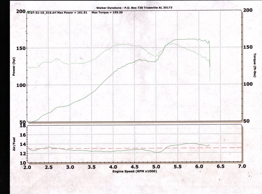

                          Here is a representative plot from one of the final runs of the day. The roughness in the torque curve above 5k is probably caused by not quite enough timing advance.

                            Wow, that is a pretty wild jump at 5k. Is that something that can be corrected and still retain the majority of the usable powerband? This kind of stuff really interests me, I love seeing what can be done with a stock spec engine.
                            Here is my dyno, I'll just link to it so as not to clutter this thread, since it's not really relevant:
                            I'm just amazed at the top end of yours. It peaks at 160ish and stays there. Mine barely creeps over 140, with a chip. Image what yours could do with a custom tune. And that would still be on a factory spec engine...

                              That dip is typical of a stock M20B25. My guess is that it is caused by intake flow dynamics. Given the rules I don't know of anything that can be done about it, though I wish I could.
