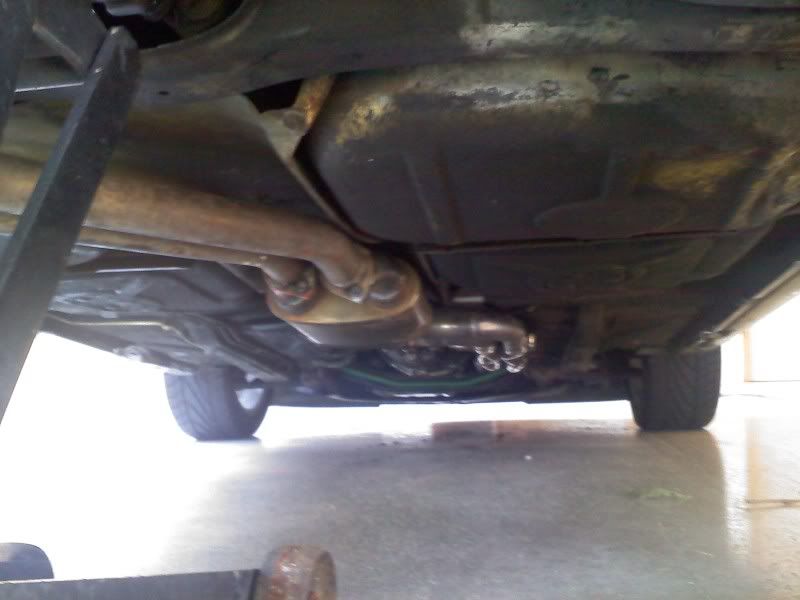

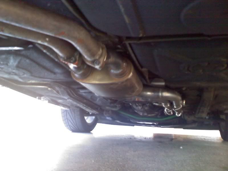

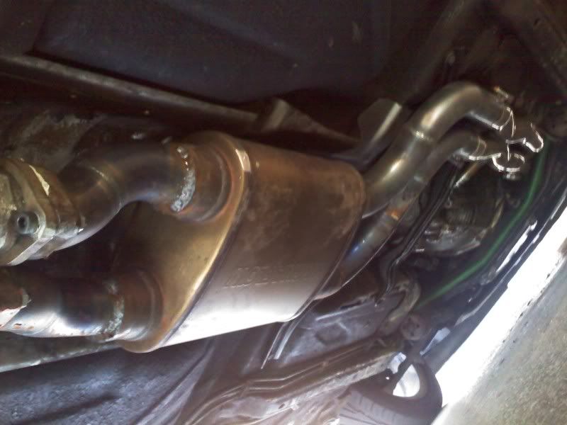

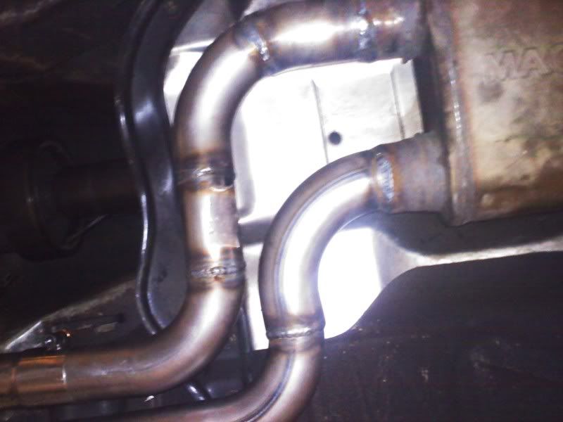

      in leu of a cat i would put a muffler in it's place like it did.
      i used a magna flow dual 2-1/4" in&out as i already had a nice cat back and was not planning on re-doing everything to a single 3".
      the combo of the 2 mufflers gives it a nice quiet rumble at idle with the 292* cam and with the ITB's, from 5K-72K it has a wicked scream esp at WOT.
      when i get back home i will post up a few picks and the part number of the magna flow muffler. i have a crappy sound bite with my cell phone too.

          a gutted cat is pretty f'ing loud in my opinion and does not sound very good. i did glass packs at first, but they were too buzzzzy for me and would buzz when i lifted on the throttle and inbetween shifts.
          as promised pics:
          and a crappy sound bite from inside the car
          the muffler is part number 11378
