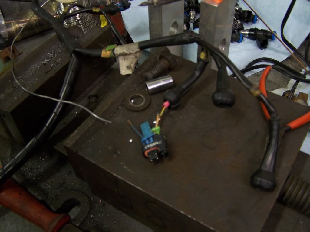

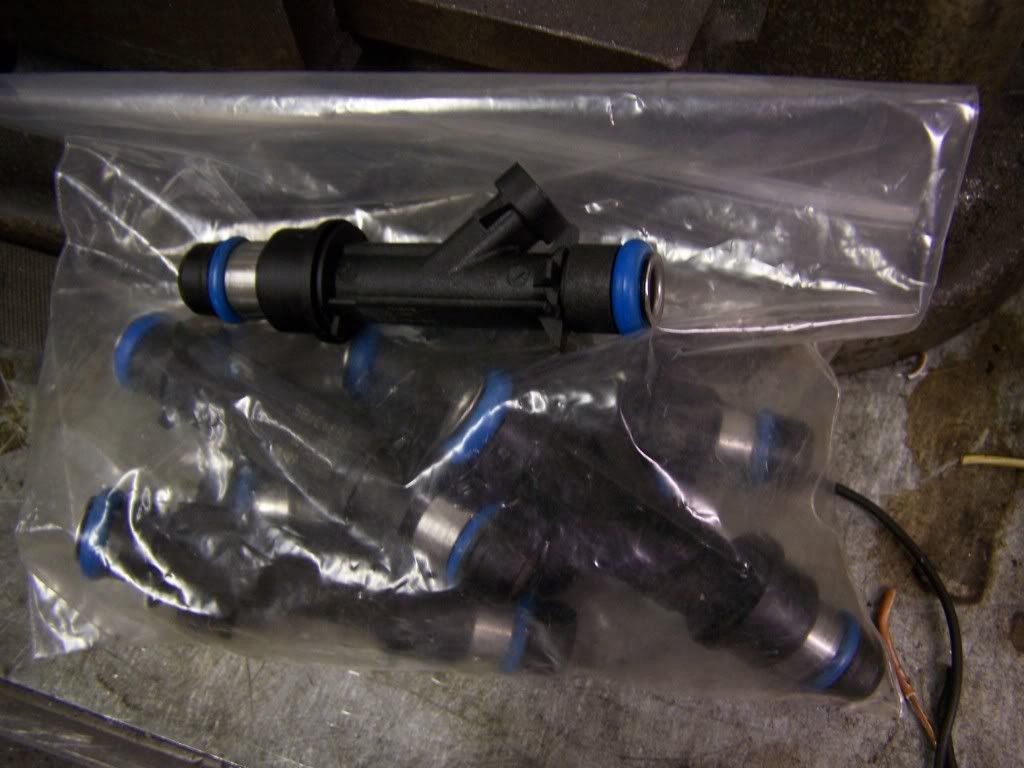

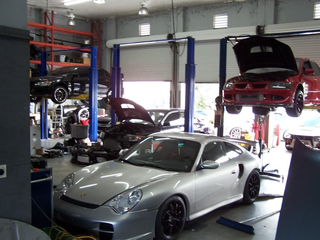

                            #88
                            on the rollers
                            pic of their shop (they have an 8sec EVO)
                            new injector harness
                            new injectors
                            Felt so inadequate compared to some cars there, but they like us haha
