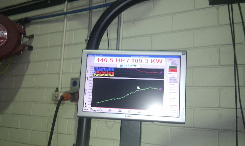

                  My stock M20B25
                  Hi guys, new here, just came across this thread and it is interesting to see modified M20's (ok using basically a mix and match of stock BMW parts) and what they are doing on a dyno. I just bought a 1988 325i manual coupe, and went through it back to front with a big service incl dist. cap, rotor button, timing belt, waterpump, radiator, all the hoses and the usual service stuff too. Plus a rebuild 3.91 LSD. And then it was down to the local dyno for five runs using premium fuel.
                  I bought the car after looking for 6 months, it is incredibly original and never been modified in any way. It has 190,000 kms and has had mainly dealer servicing. Attached is the dyno result. The first run produced 138hp ATW, and the second from last run produced the attached 146hp ATW. So from I can gather, you have to be careful not to backwards when modifying these engines. To me, a lot has to do with the compression ratio and pistons. The ETA engine was always originally designed as a high torque economy engine.
                  The ETA crank can be used, but the best result is with custom pistons. A friend has just done a run in dyno at 5000 rpm producing 205hp ATW, using the ETA crank, 11.1 JE pistons, and a baby Schrick cam, and stock computer and intake.
                              http://www.r3vlimited.com/board/atta...1&d=1284891195
                              I highly doubt that a 2.7/2.8 M20 can make 205whp @ 5000rpm, that works out to be 215wtq and is waht S50/S52 with 3L+ make.
