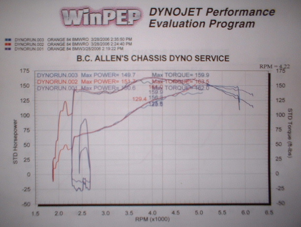

      A B27 bottom with a B25 head that is milled makes more power than a B25.
      Here's Mitch's dyno to prove it. Take the integral of the power curve and it trumps a b25.

        That's a strong 2.7i build. It's stronger than most of the other dyno sheets people post for what they see from the swap, which makes me wonder if that motor is running all stock components. That is, what would this same motor put down with everything like it is here except using the b27 head? My guess is probably more than a normal b27.
        Yeah, the torque output at the bottom end does mean an integral increase in output, but is it worth all that effort? I'm not trying to say I'm right and you're wrong; I'm totally open to the notion of being wrong here. I just think that if you were to put as much effort into that kind of build with a 2.5, you would see a greater return than producing the same amount of horsepower a stock motor puts out, which is what your chart shows.

          I spoke to Mitch, maybe he can chime in, but I spoke to him over the phone and the engine dyno'd there is otherwise entirely stock. Even the exhaust. Compression ratio has a large impact on power, and a bump is easily achieved by milling as long as you are mindful of piston-valve clearance.
