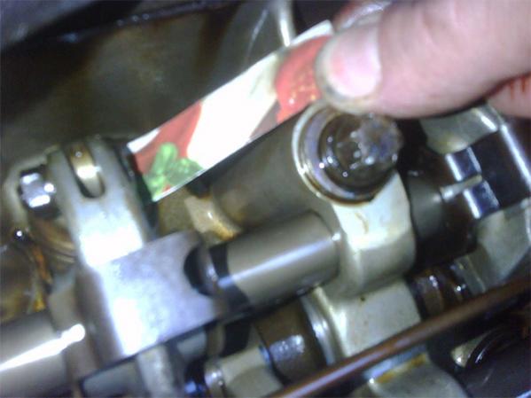

                I'd suggest you adjust them cold, with a herring can lid.
                Very simple to do:
                1: Misplace your feeler gauges
                2: get angry
                3: find micrometer
                4: measure stuff until you find a .010" object
                5: cut the herring can tab into a rectangle
                6: adjust valves
