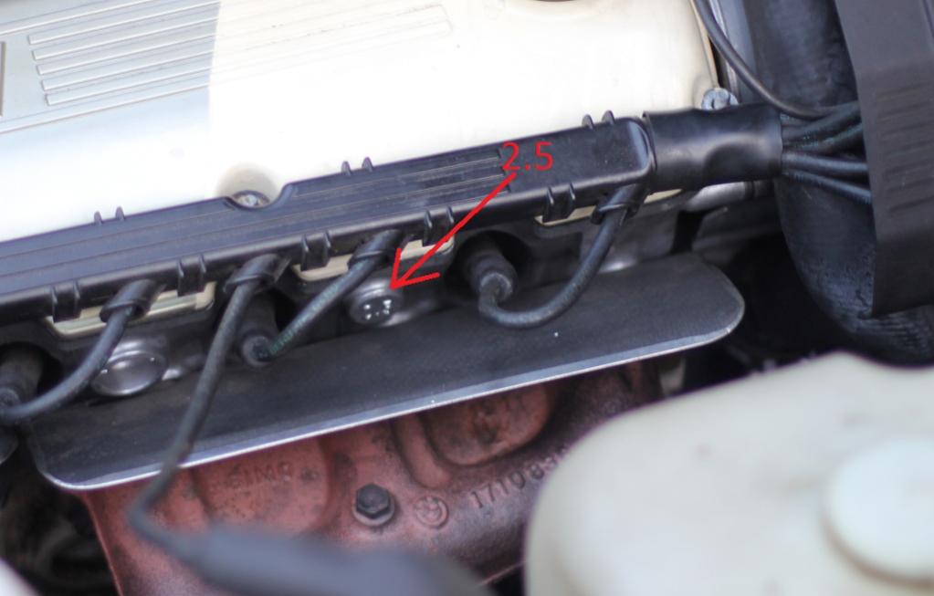

                BMW head: right over the exhaust port #2 you will see 2.5 in raised number.
                the AMC and 885 are hard to see when its on the car, because the intake manifold blocks the view.
