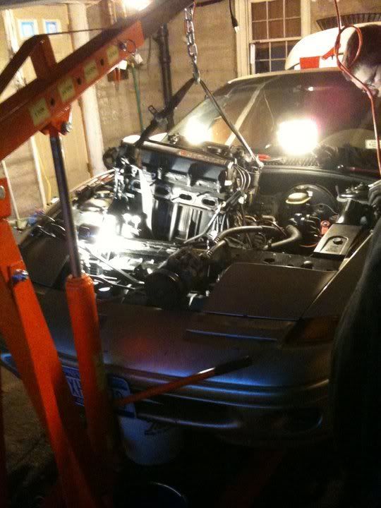

      I didn't use a load leveler ether one of the times pulling my M20 (Twice). I Recommend having two lift points. But you done have too. Just keep a GOOD eye on the hook of the engine hoist. Used a chain when dropping the M50 in, helps a lot.
      There will be ATF EVERYWHERE if you don't drain the tranny.
      Seatbelts work nicely as well.
