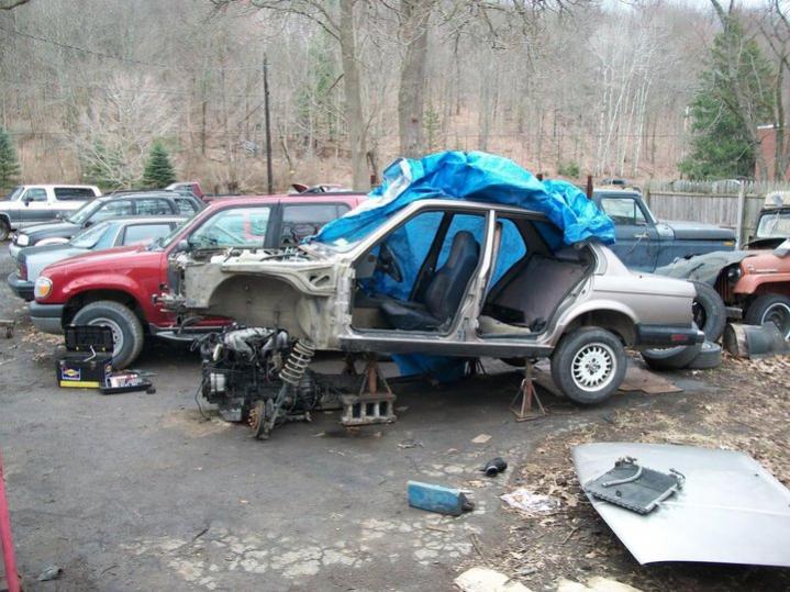

                      If you split the tranny remember to label the TPS wires(two of them).
                      Good luck and don't let anyone fool you, engine swaps are easy. I learned my first one at 11 years old on 1979 Ford with a big block. My job was to remember what went where and hook it up. Not hard on a carbed engine I know. But this is my example of you have to start SOMEPLACE. Not one single person on here started out knowing jack shit. So just label and take your time, I currently have the m20 swap down to 3 hours out and in/running. Lift makes it happen though.
                      I personally would suggest dropping out from the bottom. Get ramps and get that front end up enough to clear the intake manifold. Unhook all wiring and steering rack, then when you're almost done with everything hook up the picker to the hanging points and lift up to remove the subframe. Make sure you use a long chain so you can lower to the ground and not hit the core support.
                      It is that easy, done it countless times before I had a lift.
                      Did it last year when the lift was full at the shop.
                      Last one you can see how I used jack stands to get up high enough. These are HD homemade stands that can support full size trucks. So i would suggest not going cheap on these if you go this route.

                        Hmmm that does look enticing. However.. how you must lower it on to a roller of some sort right??

                                #60
                                Correct, since I was not using the motor I just dragged it out. But when it was needed again I would use a low creeper.
