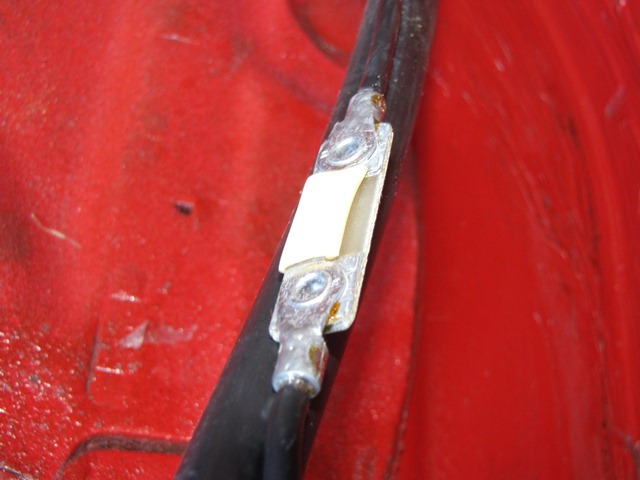

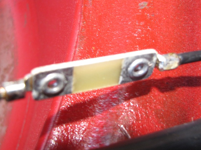

                -will a fuse link be my culprit? since no power to DME???

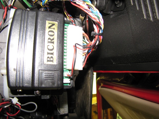

                This is the condition of the fuselink and I think it is ok. The car was starting before and during the dash swap it was after the dash swap that the problem started. The alarm had (2) 10 amp fuse and i left it in. The alarm sounds that it arms when there is power present and it seems once the key is in it disarm (but not sure) also it has so many wires connected that I do not know what to do. Therefore I removed the alarm fuses and the car cranks but will not start, sme with or without the alarm.
                I'm lost now?? F***k (I feel frustrated)

                  You mention that the car has an aftermarket alarm. It may be interrupting power to the fuel pumps.

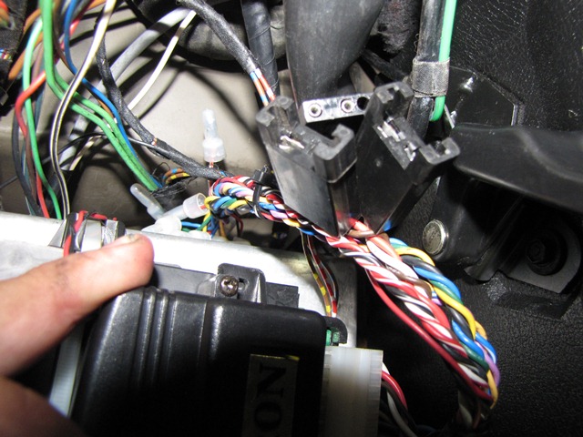

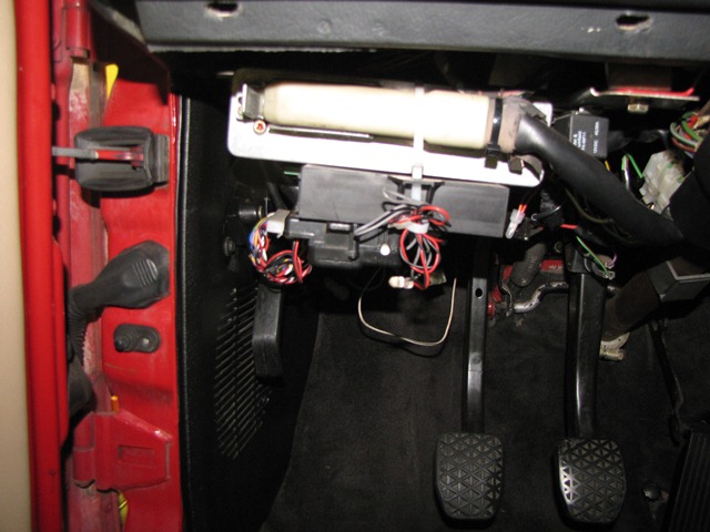

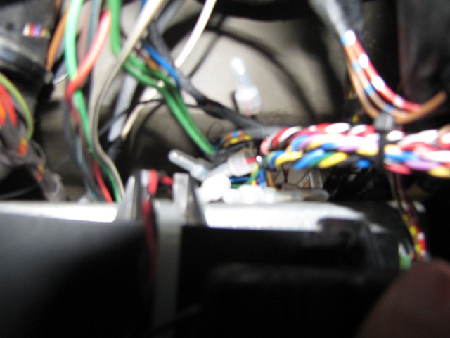

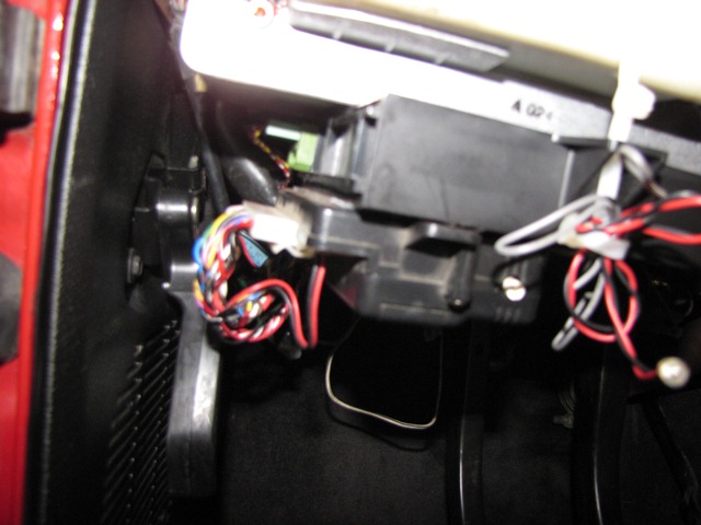

                    There are so many wires I would not know which one to unhook....
                    ALARM Photos attached, please help
                    • jlevie
                      • Nov 2006
                      • 13530
                      If the alarm is inop, which is probably is, the first thing to do would be to completely remove the alarm and revert the car's wiring back to stock. The wiring diagrams at http://wedophones.com/BMWManualsLead.htm will be helpful. Basically it is a matter of tracing each wire from the alarm, figuring out what it is connected to, and undoing what was done during the alarm installation. Kind of a tedious job.
                      Jim Levie, Huntsville, AL
                      • amcink
                        • 788
                        What is the metal box above the alarm that the cables are hooked up to? so I could reference on the electrical manual.
                        The only thing is that the car used to start and run fine. It was until the dash was swapped the that the problem started. I hooked all the electrical before I install the new dash and after i remove the old one in order to test and everything was running fine. Then I un-hook everything and install the new dash and re-hooked all the connectors; then i had the problem that the car did crank but did not start.
                        What could I have missed or hook back wrong?

                          You mentioned the alarm had a blow fuse in it, once replaced, it wouldn't stop beeping....and now it doesn't start.
                          Do what Jlevie says and remove the alarm...or at the least retrace the entire wiring setup of the alarm and make sure its done right...thoroughly

                              aftermarket alarms are the root cause of soooo meny issues. ditch it man.
