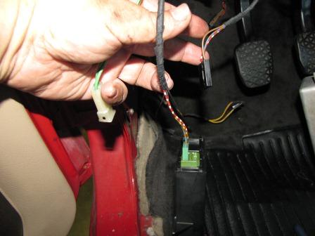

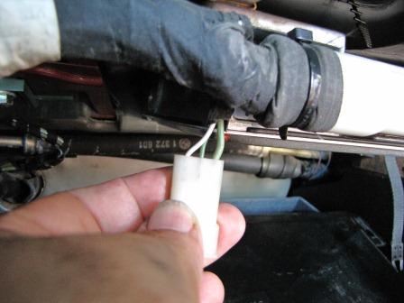

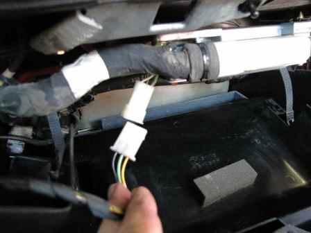

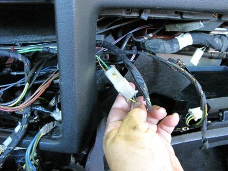

          In the effort of trying to connect my OBC harness correctly. (since I believe this is the one that is giving problems with the no start)
          On the OBC wiring harness there are two branches that comes out after the large (green) pin that goes to the OBC computer they are:
          A)A female Plug that comes from the OBC harness to the DME is a plug with a GR/RED, YELLOW/WHITE and BLACK wires (see photo). The DME plug and cable are GREEN Large,GREEN small and WHITE therefore both plugs wire colors does not correspond. I'm I missing a different plug/cable to the DME?
          B) A male Plug with a number 23 GREEN/RED, YELLOW/WHITE and BLACK that connects to a similar plug in a diffrent harness since i found a male with similar colors of wires. Is this connection correct?
          C) Does the OBC relay needs to be plug or not since it can be interrupting the power to the DME due to the CODE feature (which I do not want) The plug that comes from the OBC harness is green and goes into the OBC relay (rectangular - female); however I do not have another green plug from a different harness that goes into the OBC upper plug (rectangular with rounded corners). Terefore shoudl I connect or not the OBC relay if one of the plugs is missing?
          Please bear in mind that I'm coming from a 9 buttons and during the dash swap i did the 13 buttons swap and the harness that I'm using is the one that came with the 13 buttons.
