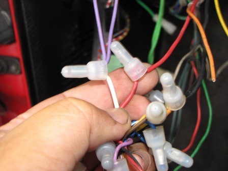

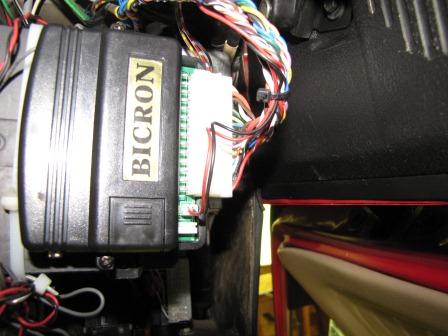

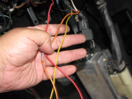

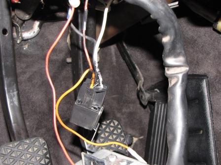

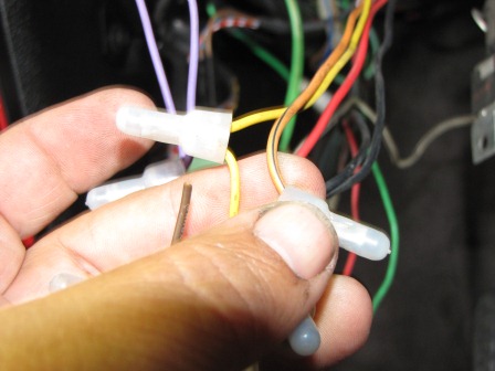

      So I disconnected the alarms (see photos)
      • amcink
        • 788

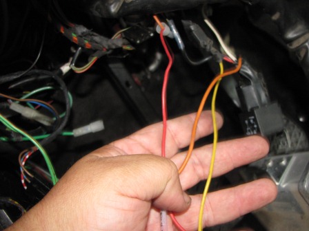

        More of alarm disconnections photos
        • amcink
          • 788

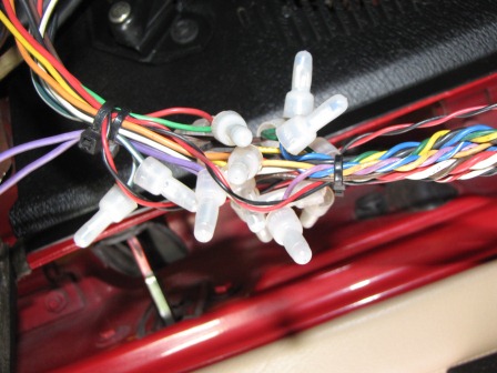

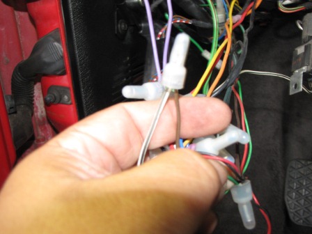

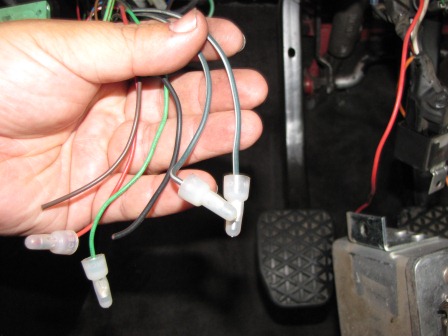

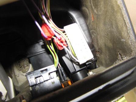

          After disconnecting the alarm these are the wires I have left that I need to reconnect- but I need help to find out were I need to reconnect them. Also some of the wires from the alarm were hook up to the black fuse

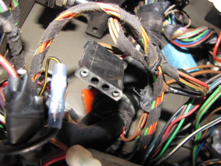

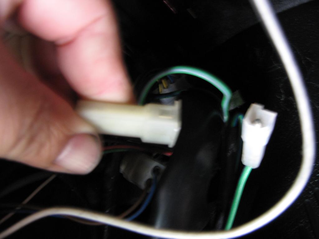

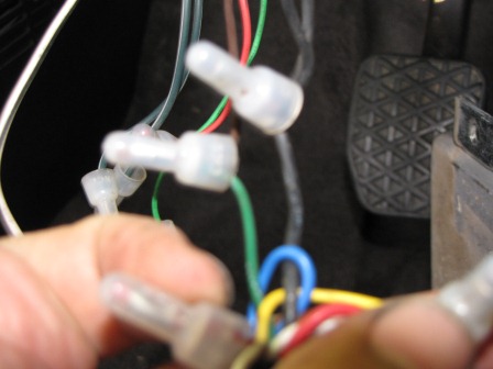

            Finally there are some plugs I neeed to know where they need to be connected

                These photos do not say much. As you can tell tho, there are after market wires under your dash and OEM wires. Cut out any after market wires and connected your OEM wires together. You need to match OEM wires color for color.

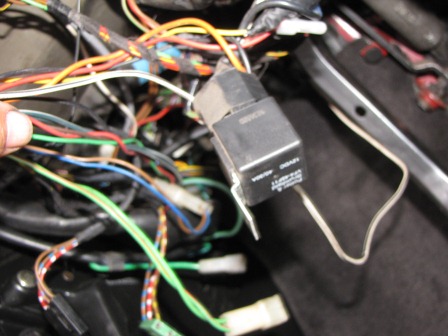

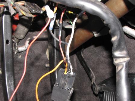

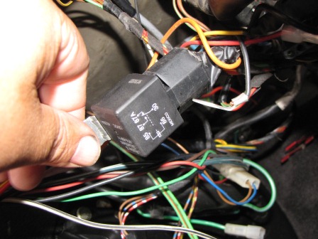

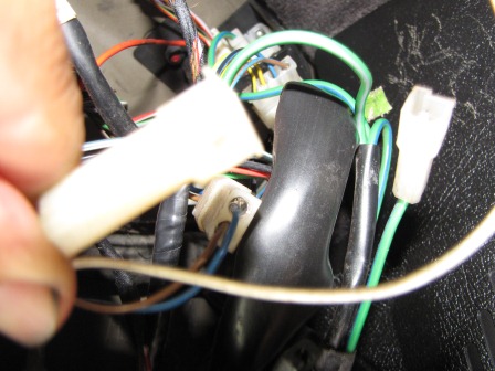

                  So I was able to traced back most of the wires from the alarm and yes they were aftermarket and they were slpiced with wires from the car. So I disconnected and make sure the wires of the car were not damage and tape it. The only one that I'm not sure about if it is correct on how is wire is the one on the photo (a relay). Would you please let me know which relay is this so I can rewire properly.
                  Next I try to start the car and it did not start same symptons. I checked if both of the fuel pumps made noise to see if they operate and had power but they do not. I think this is my problem. I cheked the fuse #11 and it is ok, the relay I changed it 3 times with other used I have and the car did not start.
                  I will get a brand new one to see if the others were bad unless there is a procedure on how to check the one I have. This is getting frustrated every day it pass with out starting it.

                    Don't bother looking at the relay wires. Look at the color of OEM wires that the relay is connected to. It will become clear which was was "interrupted" by the starter relay, if that 's what it is.
                    Once you cut out the relay, including the after market wires, you will only be left with 2 wires, which will be the same color. This is most likely your "starter" wire but cannot confirm without looking at the car myself.
                    This should be your ignition and starter wires. All need to be complete without being interrupted by any relays.
                    Constant 12V+ Red Ignition Switch Harness
                    Starter Black/Yellow Ignition Switch Harness
                    Ignition Green Ignition Switch Harness
                    Accessory Purple Ignition Switch Harness
                    Now if you complete all these you will be fully bypassed for ignition and stater. Since you found that your fuel pumps are not getting power, you can trace that circuit down. Read the ETM section or Bentley manual regarding troubleshooting fuel pump.
