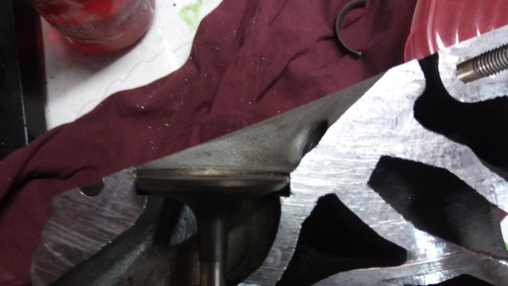

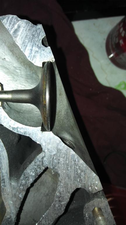

              Something interesting I found is the 885 head does NOT have the valves perpendicular to the seats!!! BMW "leaned" the valves in relation to the sets by about 2°. Always noticed doing valve jobs that the seat is always thicker near the spark plugs.
              From vertical, the m20 valves are splayed longitudinally 0°, and 20° transverse.
              Here's a pics of a sectioned head, seat removed, guide/valve reinserted.
              As you can see, the seat pocket and valve guide boss do not correlate....
Name:	m20 valve to seat angle 2.jpg
