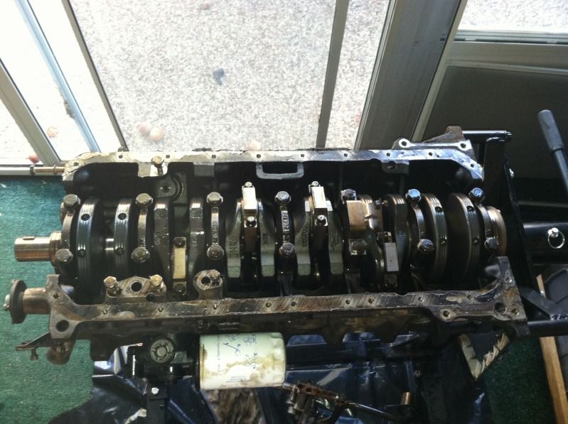

    So I'm doing a complete engine rebuild on my iX and I've stripped out everything but this damn gear. The gear is on the bottom of the inside of the block. The gear takes turning power from the belt and directs it (by shaft) to the oil pump. Does anyone know how to remove it. <or direct me to where I can find a DIY on it.
    It must come out, the block is going to a furnace for cleaning.

    Ha I was wondering the same thing I am at the same place on my iX rebuild

      WEll from the second photo it looks like you need to remove that 10 or 13mm bolt to remove it right?

        It looks like the cap (on the bottom outside) should be pried off. But I just don't know... plus I only have ONE block to try it on ONCE!

            remove the bolt and the holder will come off.
            then the cap should come out; its held in place by the O-ring

              pry the cap off.

                I will have to pry that cap a little more. I pulled the holding clamp and pryed on the button, but it is on good. If I do tear it up there is a few more caps at the local pick and pull.

                  don't worry about marring the top too much, the seal is much lower inside the bore.

                      Solved + Pics
                      Thank you guys for the input/answers
