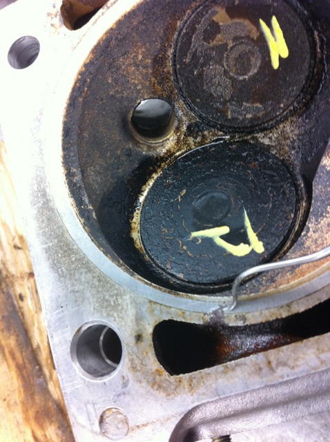

            • AlphaE
              • Sep 2011
              • 503
              This is my corrosion. It's maybe 4-6 thou deep.

              • jlevie
                • Nov 2006
                • 13530
                I have yet to see a used had that would not benefit from a mild (~0.005") surfacing cut. So I always have that done to a used head. And while the head is at the machine shop it will get a valve grind, guides checked and perhaps replaced. And of course new seals. I'll have the cam profiled and if worn it will get reground or replaced. Oh yeah I'll have the shop check to springs to see if any are soft.

                      • Cabriolet
                        • 9620
                        the easy answer is see that divot in your pic. it's near the outside of the casting. thats how deep you can take off without needing to get fancy and retarding the cam gear or getting a thicker gasket. use the OEM gasket and not VR.
                        Much wow

                        • AlphaE
                          • Sep 2011
                          • 503
                          as deep as that divot w/o fatter gasket?? or gear... i kinda doubt that..
