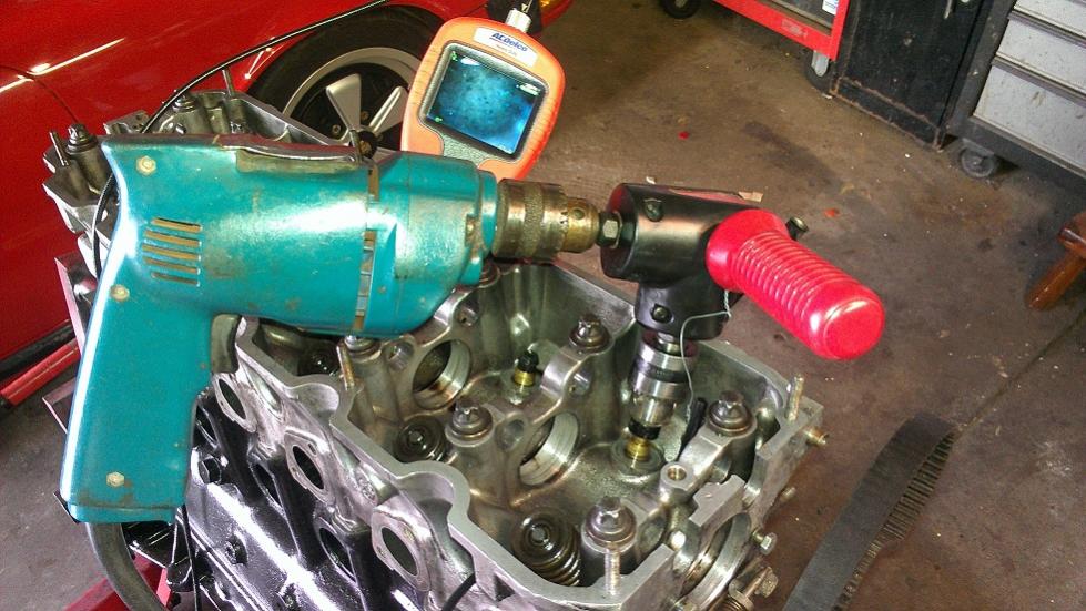

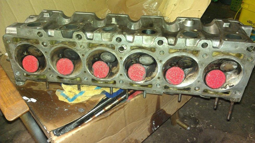

                  You can easily deepen the piston pockets with a sacrificial head and drill.
                  This might look scary but works fine. Done this for years with many cars, never a problem.

                    ^^Vin-B I love it! What a cool way to make that happen. Machine shop-schmachine shop!

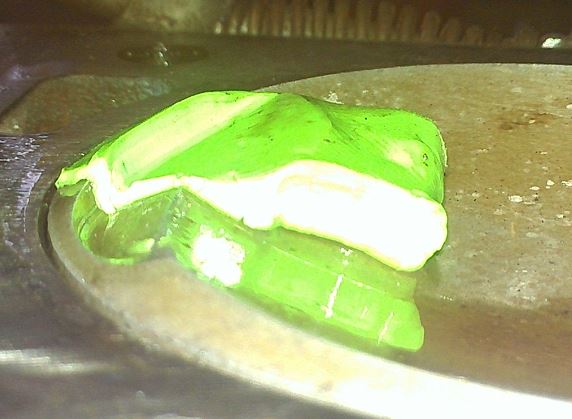

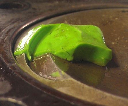

                    I just clayed the intake clearance on my decked head (past the dimples) & spare block. It was exactly 1/8" or .125" or 3.175mm. So I think I'll be well in the clear as far as piston/valve clearance goes. My mind is eased.
                    Thanks everyone for the info.

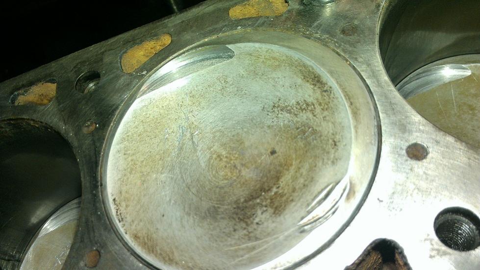

                      great photos...you are best targeting about 1mm but no more 1.25mm on the squish piston to chamber clearnace which looks ok in those photos. then deepen the pockets as needed which is what Vin-barrett did. as opposed to running a thicker gasket to increase piston to valve
