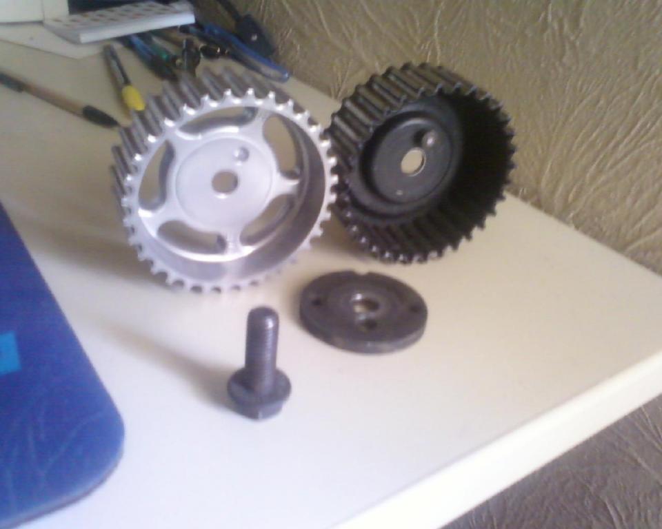

          I have look at both and also did not know there was a difference. After inspection the one on my car look ok and worked but I am in a climate that does not rust as much.
          I would rather change it than risk it. Here is a picture I took, the cast one looks like it will fold in half on itself because the bracing is a big washer sitting inside the thin metal of the gear.
          The updated sintered gear actually has some structure. It's your engine and not too hard to change but changing it gave me piece of mind.
              i messed mine up, its the one on the right, so i was wondering if there is a difference between the two shown, they look like different sizes.

                There was a service recall on the stamped gears due to some early failures and I dont think you can even buy them anymore. I bought the newer gear from the dealer for $20.

                  they are the exact same size, same number of gears, I lined them up. The only difference is you don't need that silly washer in the picture.
