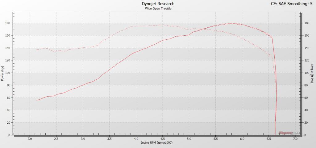

              How much compression? We just did a budget stroker using eta crank/rods stock b25 pistons (~9.7:1), block shaved 2mm, stock cam and it made 180/178 at the wheels. Also no porting, just a good valve job...

                I did this years ago and hit the dyno (ignore the 200tq number, that was a fluke with the ignition pick up)...
                Since then we played around with various combinations, most ever made was 145whp/170tq, stock eta bottom end with 885 head/cam, open headers, eta intake manifold and 325i throttle. Great for TQ, but a stock m20b25 is still more powerful.
