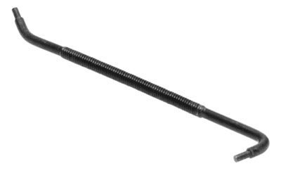

          there is a spring loaded tool that helps with setting lash its cheap and saves time dicking around
          http://www.sirtools.com/bm3013.jpg
          http://www.sirtools.com/bmw_page_2.htm
