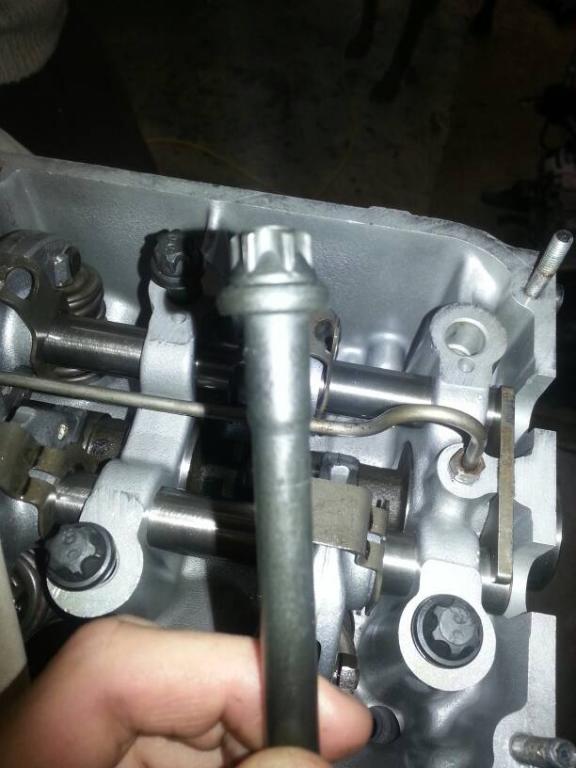

    Hey guys I have my new torx updated head bolts but I don't have the washers as I threw them out with the bolts :-( do the new bolts need washers?
    I've attached a picture of the bolts.
    If I do need bolts any recommendations where to get them from?
    Thanks

    Why would you throw them out? Yes, you need the washers.

        ill look into purchasing them wasn't sure if the part under the head of the torx was an incorporated washer

          Originally posted by eduTechnic
          Washers are to be replaced with new bolts.
          Sent from my Note 2
          I was under the assumption that stock washers were reusable, just not the bolts due to stretch. Any more info on the subject?
            They are. I just like shiny new things. I bet they're thick enough they don't really deflect much even under that kind of torque
              Sent from my Note 2
              That was my understanding as well. I've been using an ultrasonic cleaner at work for my reused parts. Seems to work great at getting all the old staining off.

                      I reused my washers

                        I was under the impression you don't need the washers at all (they may have been for the hex head bolts). I'm running washerless torx bolts and my motor is fine.

                          The washers are there to spread the torque more evenly, I'd just buy new ones

                            im guessing you dont have the preload you should if you have no washers but it is obviously still enough for the abuse it cops.

                              You definitely need to run washers guys! You don't need to replace them with new though.
