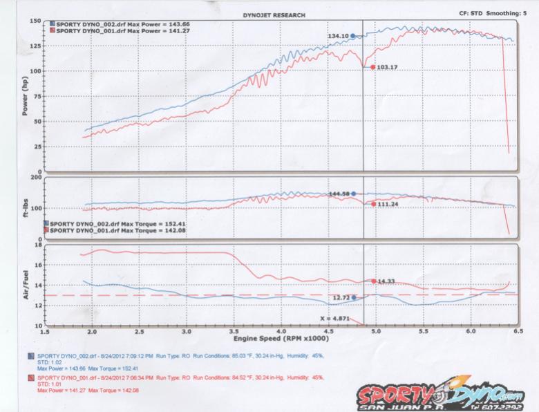

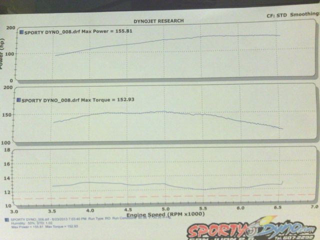

            Well my car has 156whp & 152wtq on stock 200k+ engine 3.73 diff, lightened oem flywheel, F1R PP & clutch, 2.5" single straight through exhaust to a stock muffler. Tuning is Key! Car is tuned on megasquirt, no AFM, 2.75" short intake

                  Originally posted by dougie30
                  I thought mega squirt was for fi or stroker engines? I never heard of anyone using for a almost stock m20.
                  And is it just the cam or a whole head?
                  Sent from my SPH-L710 using Tapatalk 4
                  The red line is with the stock motronic, Blue line is with the megasquirt plugged in with a street tune. the runs are like 5minutes apart. Just got out the stock motronic and plugged in the MS1.
                  The second dyno pic is fully tuned same mods, but without AFM
