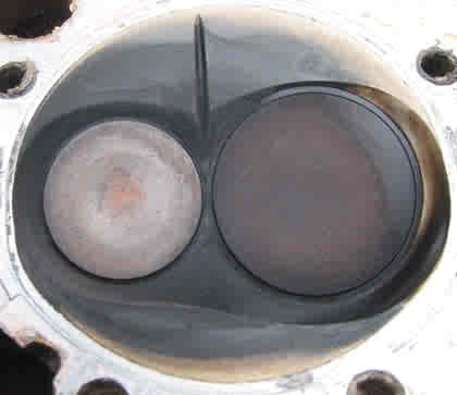

        He also puts a grove between the valves; this I have seen before and is an old flat-head trick the helps promote more even combustion in the chamber. I used to do this with the 5hp briggs & stratton minibike motors I played with while growing up, and it does indeed make for a more even combustion, and a bit more power. Was a 2MPH (25 to 27MPH) increase haha good old GPS tracking "Dyno". You can see a difference, but it's hard to tell due to the bad quality photos.
        Also another interesting link that has head work done by the same guy...
        This is a site I have created about my Canadian Chrysler (Dodge to those in the US) Daytona Shelby Z Turbo II set up.
        And before you jump to the conclusion (first thing my dad stated, and he has been doing motor/head work for a long time...)
        the grooves led to no cracks nor were they filled in by deposits, like some of the naysayers suggested would happen. The ST valves looked perfectly fine as well. Again none of the steps where filled in.

          the groove on the squish band is the somender singh groove or something. ive seen some people independantly test it and many people smarter than me have yet to adopt it
          metric mechanic treat the valve like that to. the fact that many engine builders dont use it probably means it is more of a marketing thing. the sharp angles on the valve help to shear the fuel and break it up so im guessing a texture on the valve doesnt contribute much
          certainly texture port walls and combustion work in alot of applications but some textures work better than others. the ones ive seen that have been tested to work are not like MM have at all though

            Very good read, thanks for posting that digger!
            The thing that really surprised me was that he was doing the texture everywhere. My dad has a lot of experience with the OHV V8's like the ones Larry was using as examples; the finish that he put on intake runners, and ports was identical to the finish that Larry uses, but he always "polished" the exhaust ports. Gains of 17WHP just due to the textured finish is pretty impressive. Also, the pipemax calculator was a really good thing to read about. I've seen you mention that a few times, but didn't know what you were talking about.
