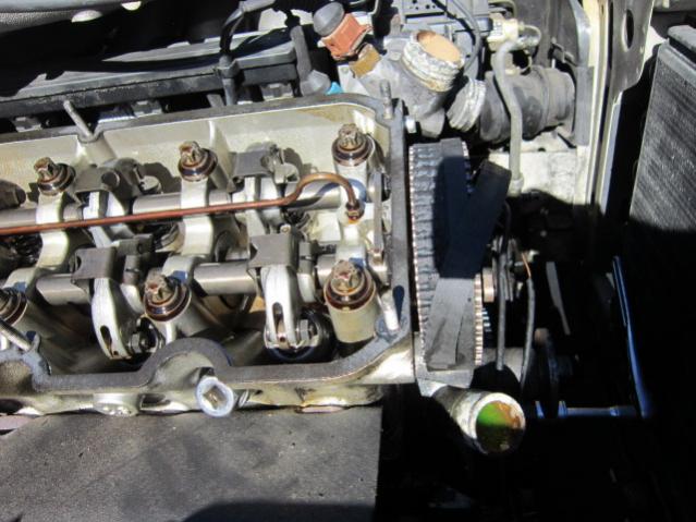

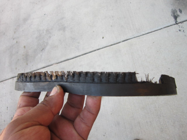

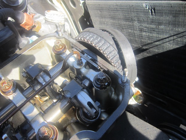

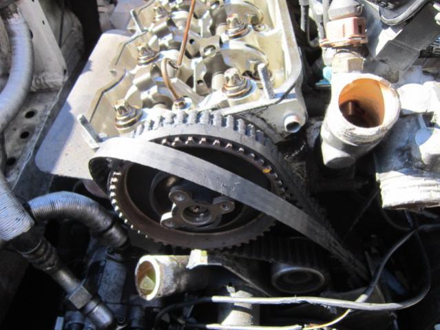

    So I was going to drink coffee with a friend last night and o my way my car had a sudden loss of power. I pulled over immediately and my engine cut off. I tried to crank it and it just sounded like it was whining (wa wa wa wa) No intentions to turn on at all. I took out my flashlight and looked and my timing belt cover was broken, you can see the belt inside was shredded. The funny thing is that it didnt break but it fell apart from the middle of the belt and the other half was good. Not sure what could have caused that type of damage, maybe the idler was bad or what. I dont know...

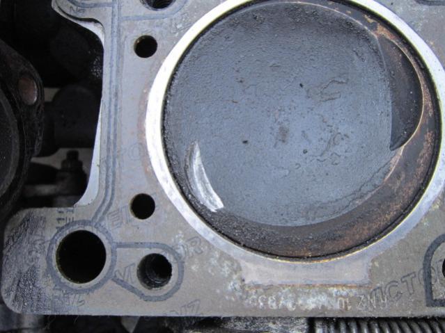

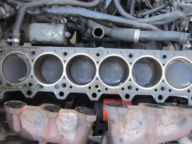

    I towed it home and took it apart, took out the plugs and cranked it with my pressure tested and ZERO compression. Looks like bent valves. The belt was only months old, as well as the head, I don't know what went wrong.
    Any suggenstions

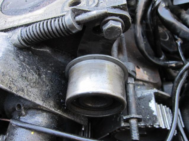

          was it one of those cheapie tensioners?
          how exactly would you overtighten it when the spring controls that?

            So can see the I just take the valves to get replaced or should I get the whole thing rebuilt? See the piston tops, they have the tell tell signs of hitting the valves.

              Not sure, it was given to me brand new with no box or wrapping. Cant rally say.

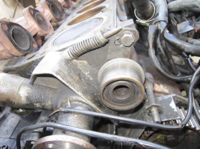

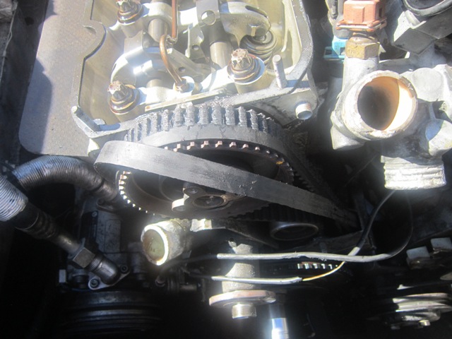

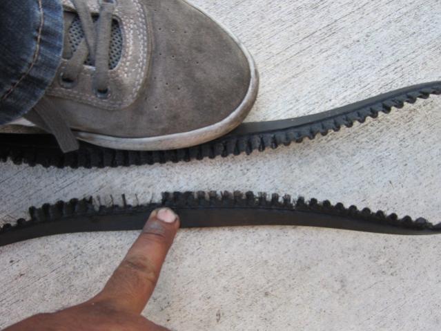

                Here are more pics of the tensioner and the belt that shredded from only one side.

                  well if you pushed on the tensioner more than the spring's force it would over tighten.
                  also check to see if debris got stuck in there and caused it to wear.
                  on the back of the upper cover there is a rubber piece that needs to be there to keep crap out. was that on?
                  the pistons will be fine.
                  as for the head. if you have money get yours fully rebuilt. new valves and guides. (as long as the cast is still good)
                  else get a pnp head, have it machined and pressure tested and then throw it on.

                    That kind of failure suggests a bad belt, or something rubbing on the center of the belt. I would not expect over tightening to produce that clean and uniform of a failure line.
                      I agree, it could be something rubbing as well.
                      Disagree on the "bad belt", would think it would have be completely separated across the width of the belt to indicate it being "bad".

                        I agree with Jim, I think its a defective belt

                          To me I thing it was something that caused it to move inwards, when I first took off the over the belt was bunched up against the head. Like it moved inward and started to deteriorate until it ultimately caught on something. My theory is that if it was a defective belt, I would have cracked and snapped. The good half of the belt looks to be in tact. Either way, today was 50% off sale at the local Pick a Part and I got a good looking head. It cost me $53.00 including the $10.00 core charge and the TB cover. Now I just need to buy the head gasket and put it back together.

                            i wonder if there is an alignment issue that caused the belt to bunch up against the front or rear? it is possible that the splitting was right at the last moment and not the initiator
