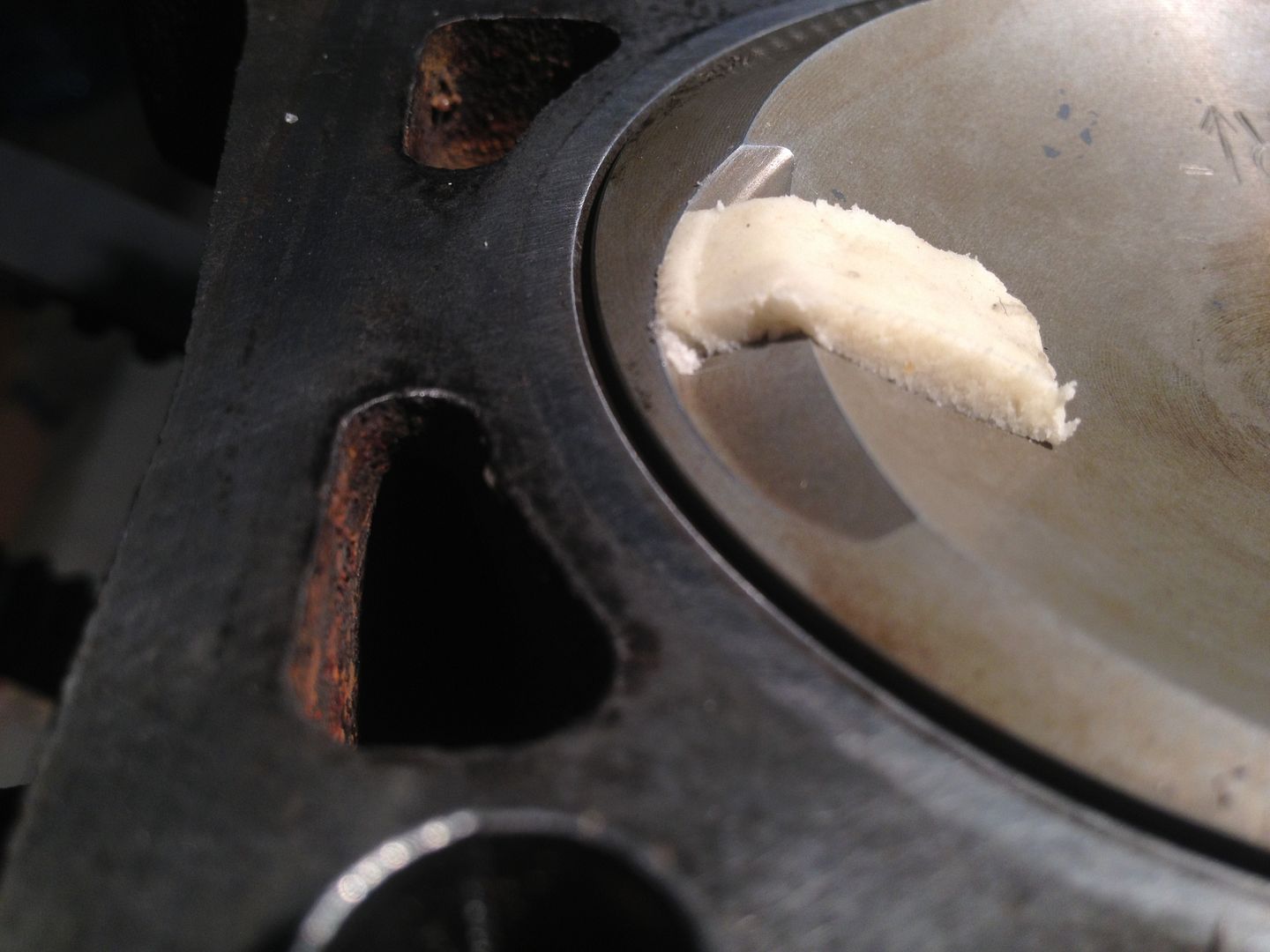

    Seta bottom end I top end P to V clearence.
    How much clearence is there when you combine a 2.5 top end on a seta bottom end with a stock camshaft?
    Is there any modification needed to do so?

    .080" was what I always used as a minimum, with .120" being comfortable.
    That was static, using clay as the measurement medium.
    fwiw.

      I know the minimum clearence was .120" your measurement ?

        you need to measure it, there will be variability in deck height, head thickness, cam timing etc
        • MR 325
          • 37833
          The i head is a direct fit to the Super Eta bottom end. There is no need to worry about clearance.

                    Yea I ment stock b25 cam?
                    How's the clearence look? Okay to everyone else ?
