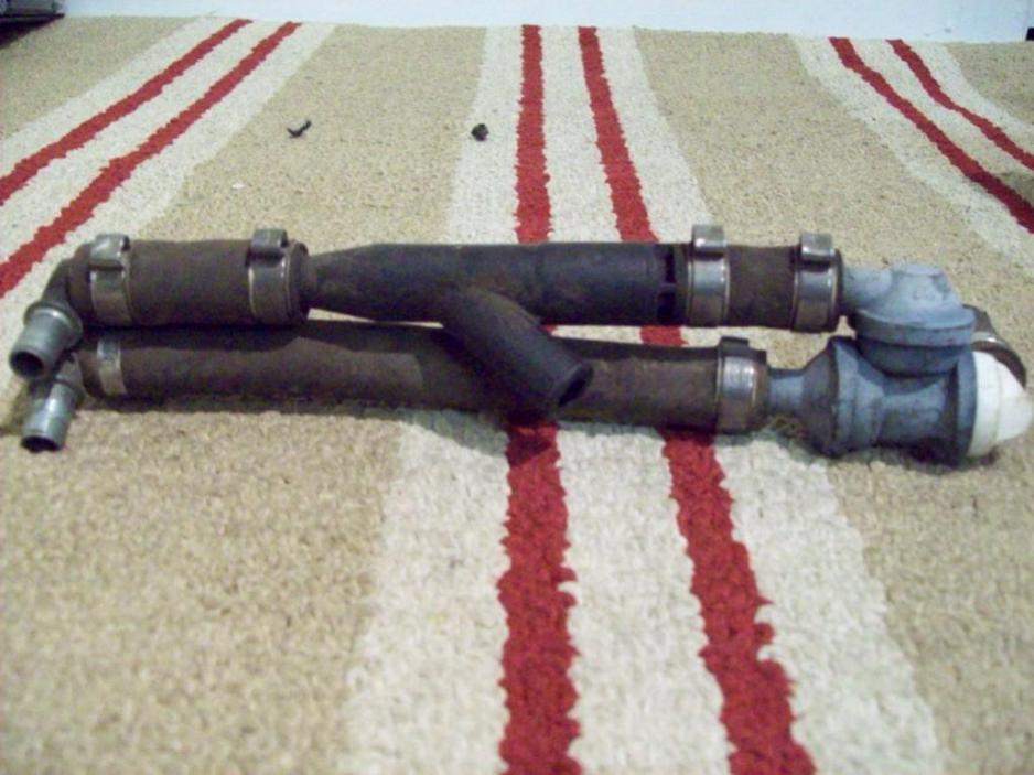

        Originally posted by Panici
        Question about the booster vacuum line setup on my M20.
        There appears to be a connection before and after the throttle body, through a Y splitter.
        All booster systems I've had experience with only have a single line to vacuum, with a check valve.
        Why is the E30 system designed this way?
        Sorry to bump an old thread. But, are these hoses that the OP posted supposed to be very hard hoses, as opposed to the flexible hoses on other parts of the car?
        Mine is very hard. Not sure if that is how these hoses are supposed to be or if mine just needs to be changed?
          I tested mine by blowing air throught the boot connection and cover the tb connection with my finger and no air was going throught the system. But i didn't know how the test the lower line
            yeah, the new hoses are really stiff. I replaced mine a few years ago, as the fittings were quite loose. If yours are tight and not cracked, I'd probably just leave them alone.
