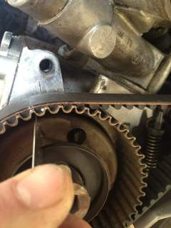

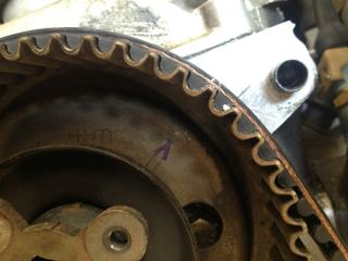

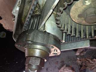

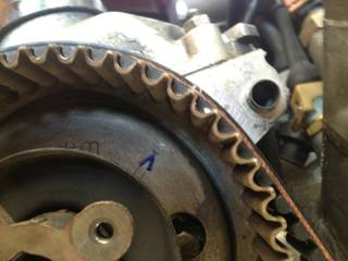

              Right now, the cam mark is before the mark on the head. (on the left) So that means timing has been retarded? Click image for larger version
ID:	7176216Click image for larger version
ID:	7176217Click image for larger version
ID:	7176218Click image for larger version
              The previous owner ran a 027 ecu with a markD chip. Could he have retarded the cam timing for improved high rpm power? What would this do in conjunction with the markD chip?

                Off by one tooth but the bigger issue are the stamped gears. Get those two replaced with the new style ones.

                  The previous owner last did a timing belt change 2 years ago and it looks like he retarded the cam timing by one tooth, either on purpose or by accident. He ran the 027 ECU with the MarkD EAT chip and 91 octane. The car ran fine, but had a rough idle when cold (it would drop low then bounce up to 900, and stabilize in a few minutes). This was pronounced when it was sub-freeing outside.
                  I have since removed the ECU and ran an stock ECU with regular 87 octane gas and the idle has not improved, and of course the engine does not pull as hard.
                  My question is this:
                  If the cam timing was retarded mechanically, but the ECU timing was advanced what is the effect on the engine?
                  Should I leave the timing as it was or advance it to TDC? Is it worth it to advance it one notch further past TDC?
                  I do plan on putting the ECU w/ the MarkD EAT chip back for the spring/summer and want to make sure I have a reliable and fun car to drive. This is a DD, not a track car, although I drive it aggressively :)

                          So, to adjust it back to stock I should turn the cam gear CW one tooth while keeping the crank lined up?

                            Yes, then do what turbo55 said about turning it over by hand to ensure the marks still line up.
