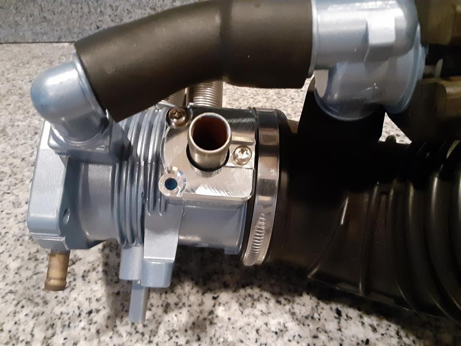

    Thanks this is exactly the information I was looking for. I got one of those spiffy machined throttle body coolant block off plates . It looks great.
    I busted off one of the bolts and figured no need to use and extractor and then retap.
    I tapped and threaded in bolts into the throttle body (as well as applying thread locker and silicone sealant ) to cap the coolant input and output. I also capped off the coolant passage on the back of the block.

      Question: The little nipple shown in the lower left hand corner coming off the throttle body. Where does the hose route to?
      The big one in the center goes back to the input on the heater core that sends coolant through the firewall to the heater core. Correct?
        Pretty sure that's the Evap line from the charcoal canister

          Thanks North! How about the big one in the middle of the throttle body? I dont think that is a coolant line after I reconsidered it. That would make no sense.

            The big one in the middle of the blockoff plate? That's the vacuum source for the crankcase vent on the valve cover.
