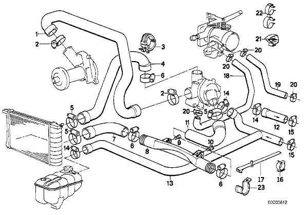

    My car doesn't have an m20 throttle body anymore because supercharger. Can I just cap the nipples at both ends, or will this cause some unforeseeable (to me) problem? There's one at the rear of the block and one on the thermostat housing.

    You will turn your e30 into a fiery bomb. Never under any circumstances do you remove that coolant line!
    Seriously, it's fine. We do it to all the race cars, and lots of street cars (to clean up the bay). Use an oil drain plug for the one on the block, we usually weld the nipple on the t-stat housing. We also block off the small port that goes to the heater, weld the one on the t-stat housing, block off plate on the back of the head.

            Will deleting the "cooling circuit" on the tb cause any issues with warm up? My car gets driven until November then is tucked away until the roads clear up from cinders and salt. I'd like to clean everything up and eliminate possible/potential leaks.
            When you mention the coolant line on the back of the head, do you mean the one that is a HUGE PITA to access? It's been a long time since I've investigated this but if I would block that off, will I still have heat?

              No, not the hose at the back of the cylinder head. Remove flow to the throttle body by connecting hose 18 and 19. The one on the cylinder head is 12. Removing 12 will not allow heat in the cabin and or damage the motor if you just try to cap it...
                Yes hose 18 and 19, and correct about not having heat by removing the heater circuit, bus as far as blocking the back of the head and t-stat housing, that is common procedure when we eliminate the heater box, there will be no damage to the engine.
                We have been doing this for years to all the race cars and cars that don't care to have the heater, never had any ill effects.

                          Thanks for the replies. I am not worried about sub-freezing temps and throttle body plate stick age. I should have been more descriptive. I dont want to just loop the coolant hoses , but eliminate them and plug them at the throttle body as well as the port on the block and also the port on the lower portion of the thermostat housing. My question is. Would blocking/ plugging these areas create a lack of cooling within the engine components. Are those areas that are used for the coolant to flow crucial areas that would now not receive coolant and cause internal engine issues?

                            I don't remember who it is, but at least one group makes a delete plate for the coolant fitting on the throttle body. Not necessary, just for aesthetics. No chance it can leak vacuum or anything if you leave it open, or just unbolt the plate and throw it away.
                            The amount of heat the TB removes from the system is absolutely negligible vs a radiator or heater core, and the flow is minimal.
                            The only reason not to cap both ends instead of loop the lines, is effort.
                              Why capping the 20 line can cause damage to engine.please explain?
                              I capped mine since i deleted my heater with no issues I've heard the connecting this line with the return from heater can cause damge not capping it.
