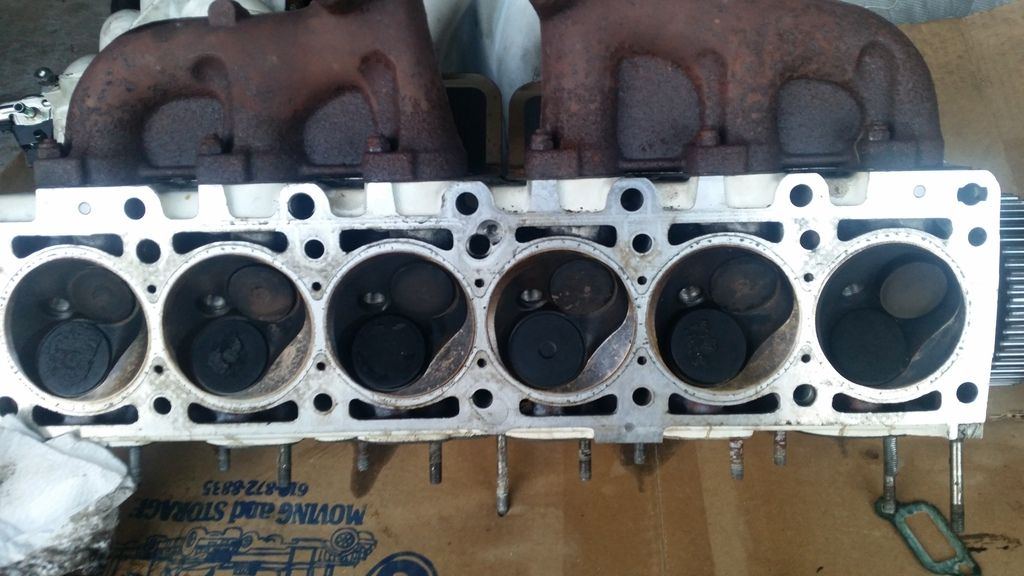

    So once I had more light and wiped the gasket off, it looked fine..
    Well here are some pictures of the valves, the valves on cylinders 2 5 and 6 have some pretty bad oil scaling
    Head: http://i1127.photobucket.com/albums/...729_194200.jpg
    C1: http://i1127.photobucket.com/albums/...729_194221.jpg
    C2: http://i1127.photobucket.com/albums/...729_194226.jpg
    C3: http://i1127.photobucket.com/albums/...729_194229.jpg
    C4: http://i1127.photobucket.com/albums/...729_194234.jpg
    C5: http://i1127.photobucket.com/albums/...729_194239.jpg
    C6: http://i1127.photobucket.com/albums/...729_194242.jpg

          So I (Finally) got the engine out. The pistons are out, the clocking was definitely messed up. I'll re-gap them tomorrow and let you guys know what they were. Anything else I can check too? The rings were all right side up and look good...

            Measure the bores carefully, and measure the pistons carefully. It would SEEM like the
            oil trail would tell the tale, but who knows... this has been a weird one. The clocking by itself
            shouldn't be enough to make it THAT bad.

              So I measured the ring gap again using instructions from this guy in this vid (FF to 7 min mark): https://www.youtube.com/watch?v=uWzeVrVAE84
              Which was super helpful. And so I realized I did it completely wrong when I did it before. first engine rebuild, I guess I was bound to make some n00b mistake
              So my biggest feeler gauge is 0.035" and every single gap, compression and oil scrapper, on each cylinder was so big that there was daylight between the ring and the 0.035 gauge. I'm going to guess about 0.040" gap.
              So then I thought... wut.
              And then after that I thought, is my block bored out by a previous owner?? so I got a fancy bore caliper from my neighbor and all the bores were dead on spec. Pistons were right on spec. So no, I guess I bought the wrong rings? So I opened my previous order on Pelican and it looks like they no longer carry that piston ring set. But it is specifically for "325i 87 thru 91, 525i," ...?
              So there yah go. I'll contact Pelican and see what is up... I'm gonna guess these rings are for a 323 or 320 or something, I have no idea.
              Anyone got a recommendation for rings and head gasket?
              Thanks again guys. sorry this turned out to be something so sophomoric.
              LESSON LEARNED.

                Try BavAuto. They carry Deves, and I've had decent luck with Deves...
                I'm still not convinced, though- 0.040" end gap's not right, I agree, but
                did the rings expand enough to seal up properly in the bores? If they weren't
                sitting loose in there, the 3 in conjunction SHOULD have sealed better than THAT...
                and I have built a dozen or so engines, and only measured end gap on 2. So
                this is a good reminder to pay better attention...

                  They did seal up against the cylinder. Idk, that is a big gap. If it isn't that, what else do u think it could be? It's apart so I can check anything

                    So, it has been awhile, but here is an update. The bore is actually about 0.020" too big. I noticed that the cross hatching I had put on was gone on each bore, then I felt it with my finger and there was an obvious ridge in the bore. So i measured again and found the bore was way too big. It still doesn't explain what happened. The bore was in spec before I rebuilt it the first time, then something went wrong with the rings and now it is trash... So looking for another block now... boring it out doesn't seem worth it, seems very expensive.

                      a month ago the bores were in spec and now they arent? 0.02" is heaps, i guess you mean 0.002" ?
                      also the rings rotate in the engine so they wont come out the same as you put them in but you want them clocked for initial breakin process

                            Digger, yeah I guess I got over excited about the clocking...
                            No I meant 0.020" over. Like, serious wear. You can feel the ridge with your finger very easily. So the first time I measured it I measured at the top and the bottom of the cylinder. Which was dumb because the bore only wears where the rings rub....
