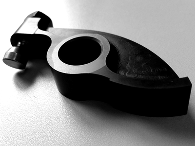

    some might be interested in this. read it on the catcams website
    catcams now have steel m20 billet rockers coated feet. longer feet to so dont have the same limits on velocity so you should be able to get more lift without excessive duration compared to the standard rockers if you get a custom cam. one of the guys over there said 290 duration you can have 12.5mm easily, compared to 11.5mm from Schrick 288
    they will work with existing cams
    id be all over this if i didnt have the RHD roller ones already.
    i think these are quite a bit cheaper than VAC billet alloy and the shitty PPM knockoffs but will be quite a bit more $$$ than cast ones. i think they are 120 each but not seen it listed officially

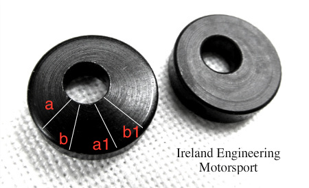

          I wonder how much does the pad height change the rocker ratio? lower pad = higher eccentric to maintain the same clearance, I think..
          Do you think the same idea applies (pic)?
              i think i still have the bits lying around if i get a chance i will try dig them out over the weekend and compare the lift profile of stock b25 with OE rockers and the IE ones to see how much the profile changes.
              it would probably be the same as the pic, the arc is the same but the position at 0 lift is different so at max lift the rocker has different relationship to the head so it can change things. the same as the the tip height of the valve can change geometry a bit to
                  so IE HD rockers increase peak valve lift of stock cam by approx 0.40 mm or 4% the HD rockers i had still had the lobe coming very close to running off the pad
                    running off the stock cam? 0.4mm is a lot. What lash was installed for the measurement? Did you use OEM springs? I don't have good OEM rocker. Otherwise I would try to find out the following:
                    1. given the same lash(0mm,0.25, whatever, as long as the same for both rockers and on the same cam), HD vs OEM....does the cam pad ramp on both provides the same valve oped duration or it's different?
                    Also if you compare assembled OEM and HD rocker with the same lash setting: Does eccentric position with HD rocker provides for more ascending eccentric ramp towards the full lift vs the eccentric position on OEM?

                      for example: at the same lash at TDC(point at a for HD and point a1 for OEM): b-a=c is the ramp at full lift for HD rocker, b1-a1=c1 for OEM. Is it possible that C ramp is greater than C1 ramp?

                        i used inner springs only so you will lose some lift due to deflection withe double springs but it is the same for both rockers. i plot with zero clearance and offset a curve 0.25mm to account for clearance
                        it looks to me like the centre point of the pad radius is probably the same on both rockers but the radius on HD is slighty larger (using a radius gauge OE is 32mm and the HD just under 34mm) so the arc is offset like two concentric arcs. this means the HD work better on the smaller base circle of a regrind as the eccnetric doesnt run out of adjustment.
                        the change results in a change in duration of about 4-5* at seat but would be more change at higher lift points and the lift increase is about 0.4mm perhaps a little more.
                        so if you are in SPECe30 and use OE rockers you are probably losing a couple of hp compared to others
                        • zaq123
                          • Jul 2016
                          • 1560
                          What do you think about my post regarding eccenrics? To dial proper lash with HD rockers, eccentric will be pushed in closer to point A on the pic vs. A1 on oem rocker. When at full lift, A moves to B and the change in eccentric's radius is greater vs OEM A1 to B1 resulting in probably greater lift.
                              Also it looks like cam pad on HD rockers is 2.5 mm longer (about 1.25mm in each direction). Should help with the "run off the cam" vs oem.
